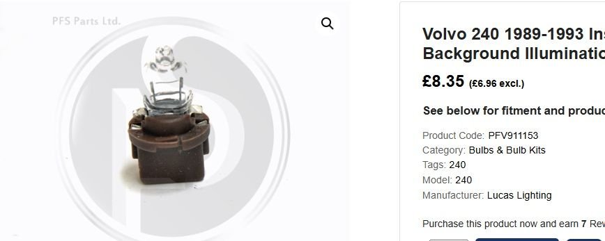

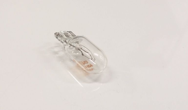

From the Volvo parts catalog The 1981 uses 2, 3 watt incandescent bulbs without a base to illuminate the gauge cluster (yes the are 3 other bulbs in the center console, one over the rear ashtray and probably the shifter that are on that same circuit - but those are little 1.2 watt bulbs)
Later 240s use halogen bulbs with a base that are still only 3 watts but are slightly brighter. Don't think they are interchangeable - but don't have access to a instrument cluster to test.
Neither bulb type is as bright as we are used to seeing in instrument clusters today.
Simply bypass the rheostat if you want to make sure you are getting full voltage to the bulbs.
Incandescent bulb in a 1981 989794
and a halogen bulb with built in base for a later car 989809
