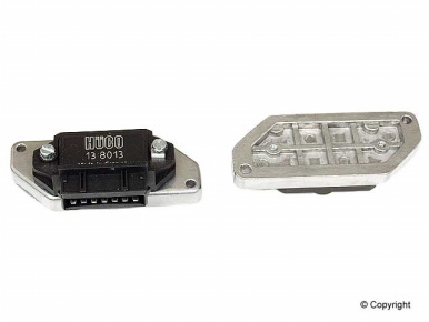

The ignition module on the driver's front fender will also cause the no-run issue you describe. It looks like this...
