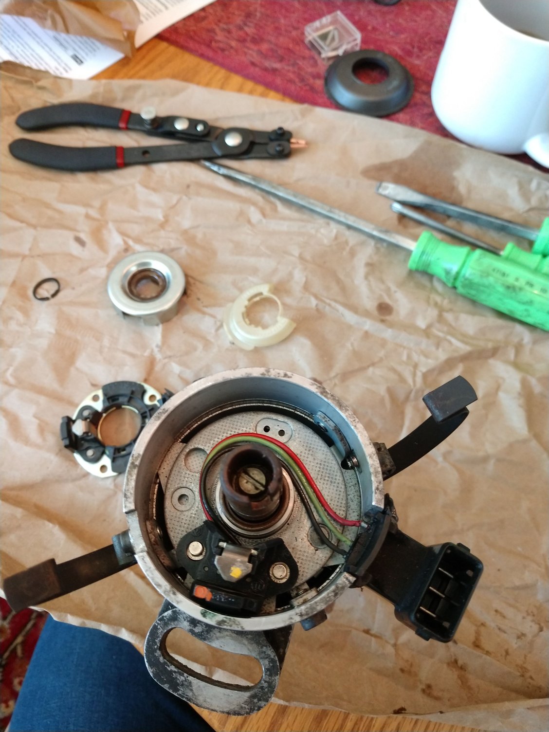

i got the new hall sender today and have a couple questions about its installation.
here's the old hall sender and its position in the distributor:
old hall sender position

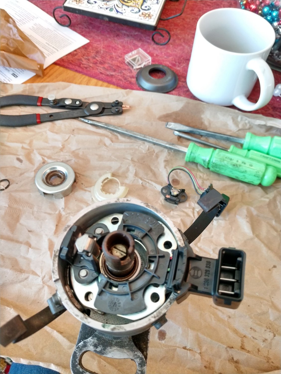

this is the new hall sender, which positions differently in the distributor. is this the correct installation?
new hall sender, resting on unit, not installed
I presume this spacer, underneath the old hall sender, must be removed, since the new unit has a spacer under it already?
spacer underneath that needs removal?
does this all look about right or no?
