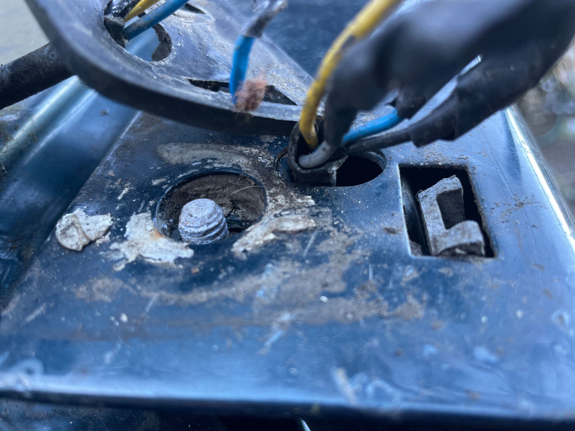

Old Feb 6, 2025 | 10:24 PM
Appleby's Avatar
Joined: Dec 2024
From: Seattle
On my 93 Volvo 240 wagon. My tailgate bolt also stripped, but there’s also a metal “thing” that appears to have snapped. So will reboring the bolt holes and replacing bolts be enough to hold the heavy *** tailgate?

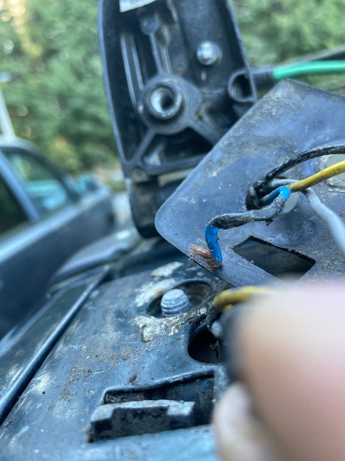

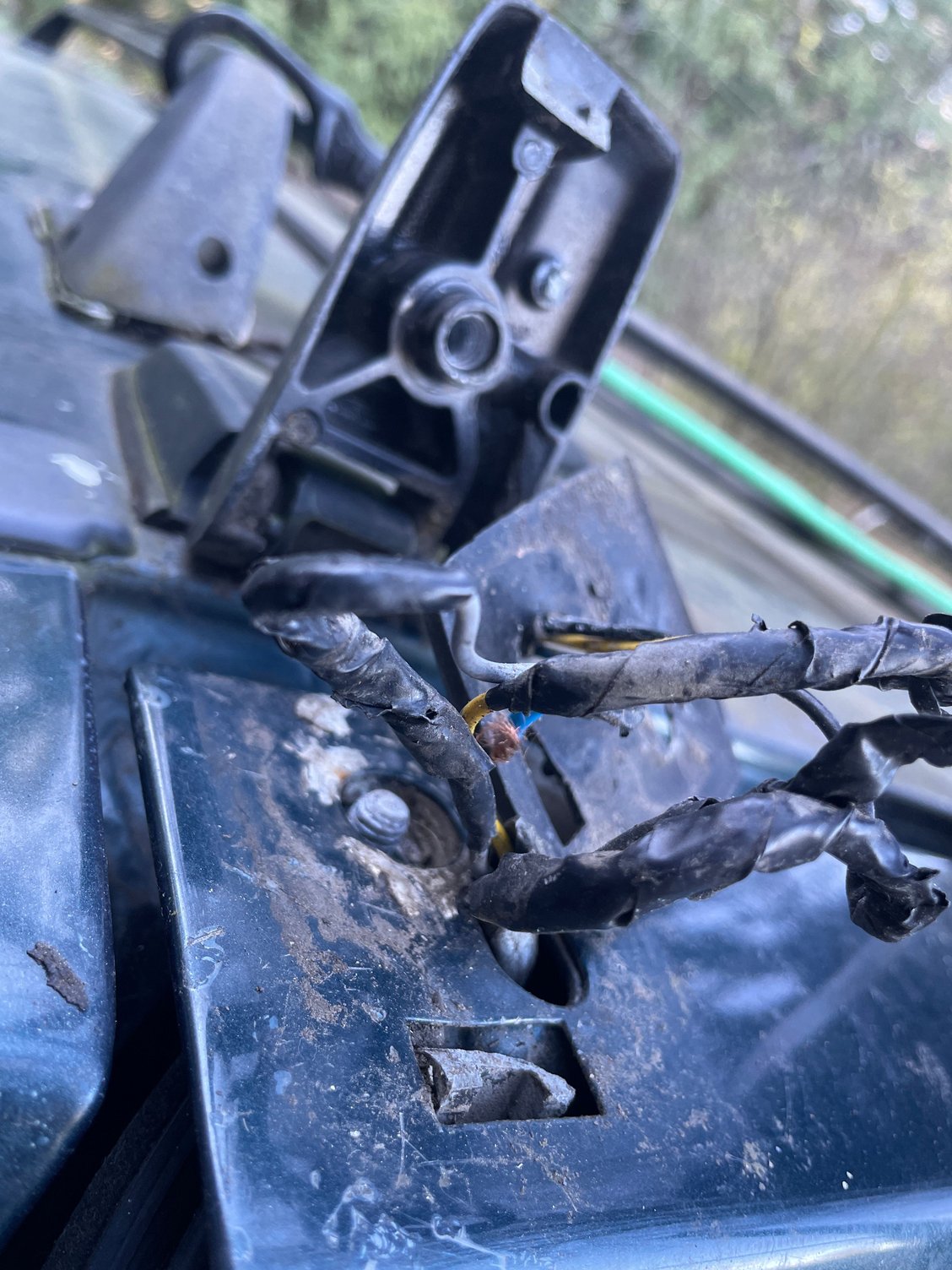

Old Feb 11, 2025 | 01:07 PM
Appleby's Avatar
Joined: Dec 2024
From: Seattle
Originally Posted by Nichals
Depends, post a photo of the damage. If it’s too bad you may need a new hinge.
hi Nichals, thank you for your reply here are some photos
I may have a line on a set of wrecking yard hinges which I’m guessing would be the best scenario but just in case it’s good for all options to be pursued
Old Feb 20, 2025 | 12:56 AM
Nichals's Avatar
Joined: Mar 2011
Posts: 593
Likes: 6
that part prevents the hinge from cantilevering out. In my opinion, without that second bolt, the threads would eventually tear out, likely when closing the hatch. Perhaps not at first, but late on a rainy night, when you are hungry and have to get to work early. Ask me how I know…lol. I would go for a wrecking yard replacement.
