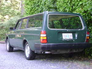

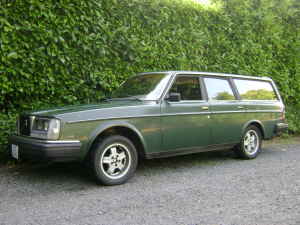

So i got an 83 245 wagon with a 4 speed & electronic OD. Incredible space with the back seat folded down! Runs & drives really good. Paint is faded but i'm curious what a good wax & buffing will do to it.
Front end rides kinda high (see attached pics). I was thinking of getting the overload springs from ipd and a set of bilsteins and their front & rear rubber bushing kits & see what that does.

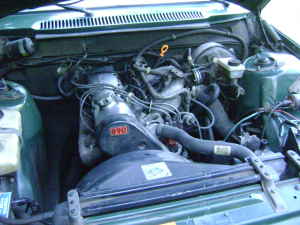

The guy i bought it from thought it was a b21 but I looked on the little tag on top of the driver side wheel well & it says 141 cubic inches. I believe that's 2.3 cubic cm's right? So b23? It's fuel injected. Not sure if that's K jet, looks different from the L-jet on my 82 Alfa (see engine pics).

NIce car and good luck. Front end does look a bit high. Its possible someone put diesel springs in the front. If you're mechanically savvy the rear springs from an old say 91ish toyota previa are identical in length and diameter but are much stronger/stiffer than the regular wagon, and even overload springs. You can get them off a junker for dirt cheap.
If it's an 83 and it looks like that its the lh1.0 injection. Could be a b230, I don't know, I was under the impression they didn't show up til 84.

Man, what a deal on that wagon.... I think with a buffer and some wax, you might be able to help bring ou tthe paint. Get the springs checked out, it does look high, otherwise it looks clean! Welcome....

Checked the VIN, it's definitely a b23.

I would go with the ipd rear heavy duty springs. I got a set for my 740 and put them on myself. I rarely seen a 240 or 740 that did NOT sag in the back so I replaced my springs before mine did and they were great. I would do those springs and leave the rest alone, maybe replace the ball joint bushings in the front to get rid of the floating up there.
The motor may have been a replacement some time ago. Those I4's almost last forever. I had 405,000 on my 740 before I let it go.
Love those wheels. They use to put those on the Turbo cars back in the day. I started to purchase a set for my 740 once.
Looks good. Have fun.
