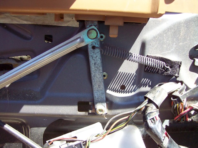

Unlike the 240's, but as with most modern American cars, the 7's regulators are pop riveted to the inner door frame in 4 places. Perhaps they grew tired of the 240's electic regulators constantly wiggling loose. Once the door panel is pulled, the forward two rivets are seen above and below the small triangular hole...

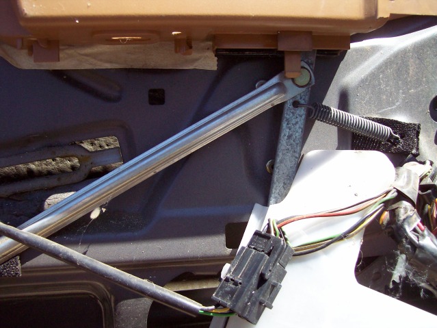

The rear two rivets are hidden behind the white plastic latch cover.
Here's the cover removed...

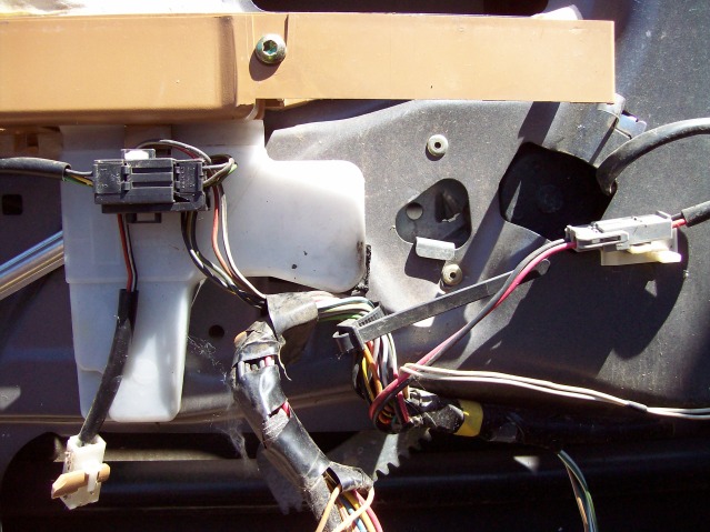

Pull the inner door latch back and they are visible...
Shop labor for the job is an hour but reality has it at more like 1.5 if you have everything present to get it complete. I always run the window down half to 2/3's so I can reach the window clips but I leave the power attached until the last as sometimes the regulator needs to be adjusted up or down to pass easily through the access holes.
