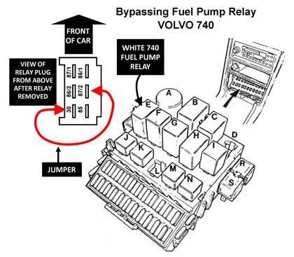

Old Aug 4, 2019 | 12:05 PM
note that you need TWO jumpers on the fuel pump relay, one for the ECU power and the other for the fuel pump. and its not easy to reach the socket on a 740 as its in the center console between a bunch of other relays.

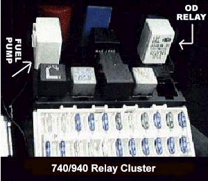

Old Aug 4, 2019 | 01:19 PM
  #17
on a 740/940, most all the relays are behind the ashtray. remove the ashtray, remove the bezel around the cigarette lighter, remove the 1 or 2 screws visible behind that bezel, and remove the lighter socket and tray next to it, now you should see the relays and fuse panel.
you need a 3-pin jumper, pin 30 needs to be jumpered to both 87/1 and 87/2 to power both the ECU and fuel pumps before the car can start. This drawing below only shows the fuel pump jumper, which will let you test the pumps, but not let the car start until 87/1 is also connected.

Old Aug 4, 2019 | 02:14 PM
  #19
scrap piece of wire, and 3 1/4" blade connectors
start with....
and 2 mins later,
