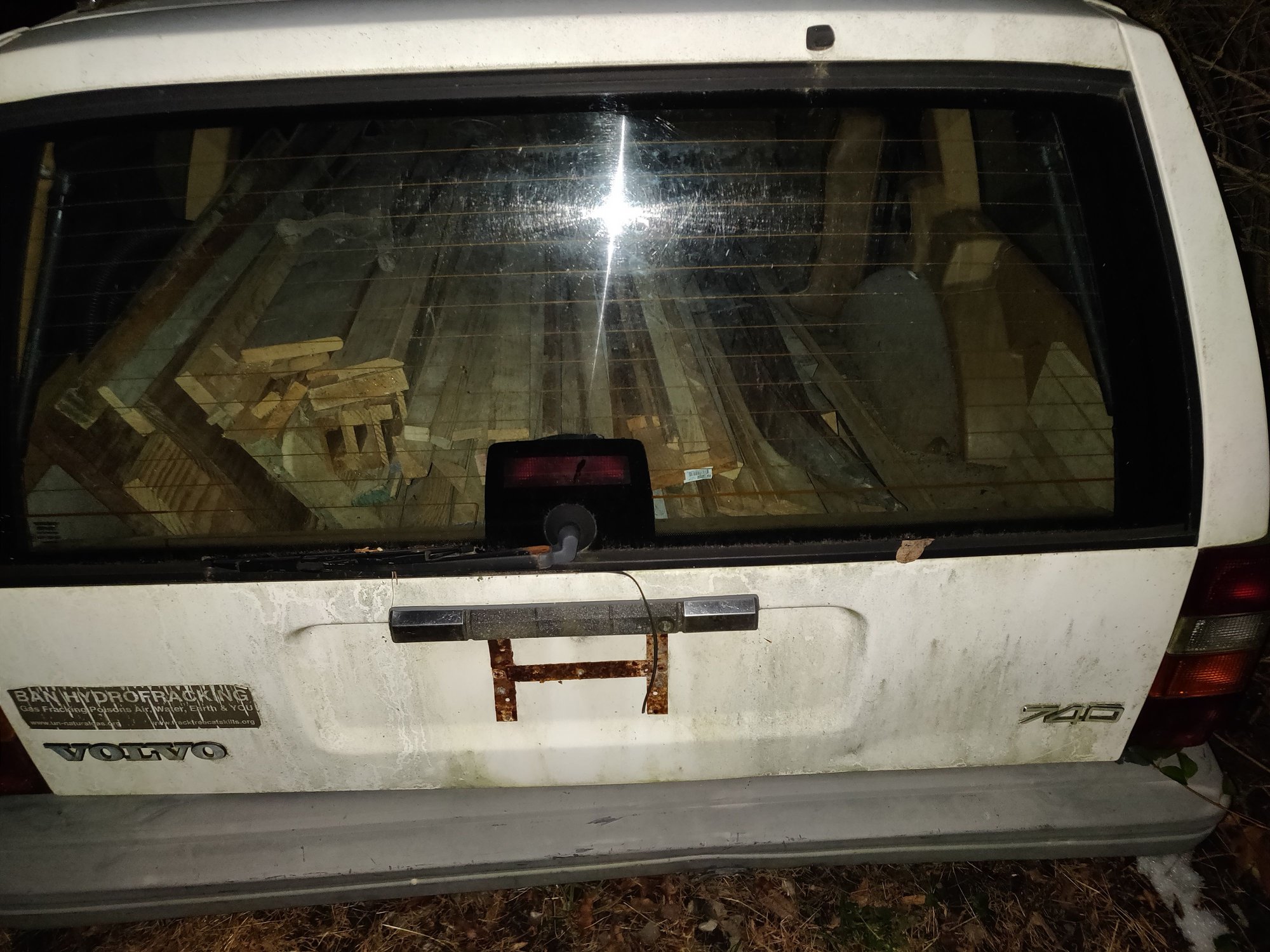

I'm picking up a 740 wagon Saturday, and was wondering if anyone has any thoughts on rear end damage - specifically, the bumper being pushed in about 1" on the passenger side and the quarter panel area being slightly folded in. It looks like the force of the impact may have pushed the metal up and frontwards, since the door gap gets slimmer towards the bottom and I didn't see any scuffing on the dent itself. Is there any realistic hope of repairing it by replacing a panel or doing any rope+tree+accelerator style bodywork? Before the trunk latch stopped working, it did close nice, and there's no signs of leakage along the weatherstripping on that side. I'm hoping that means nothing structural is out of whack, but I have no idea how these cars are put together. Being that it's got near to 300k on it and was free, I'll take what I can get, but I'd like to at least make an effort at getting it nice for the 100-200k the engine seems to be looking forward to. No pictures of the folded metal, but below is a shot of the bumper. Yes, it's a gem.

junkyard. part it out for good engine parts, IF you know the thinhg was well maintained before it was wrecked.
once the unibody is tweaked like that, its a lost cause.

You should remove the bumper to get a better idea. No body panel to replace back there, all is unibody welded except for the bumper. The tree-rope pull is impossible with Volvo structures (personal experience) but you may have some success with a big sledge hammer to get that door latch to close.

Dang, that's about what I expected. It's not as bad as that picture, the body lines are still straight and the door gap is very slight. I'll yank the bumper and see if anything can be done. The trunk still does line up except for the frozen latch, and it's mechanically decent, so I may just drive it as is. My Subaru outback is in its death throes, so this will probably be a beater wagon replacement anyway.
