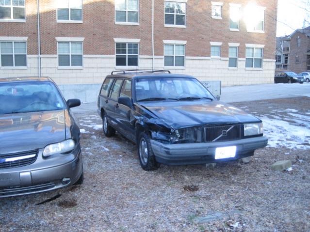

So I bought the wrecked 740 wagon for 400 bucks. It only has ~120,000 miles on it.
The kid I bought it from said the radiator was broken, but to my surprise, there were no leaks, and the car didn't overheat over a 30 minute drive! The wrecked damage isn't that bad either. I can ghetto fix it, no problem. I just put in requests for a headlight and drivers side mirror at online salvage store.
-Problems with this car:
- it burns oil out the exhaust (smokes just a little). The guy said, a mechanic said, the turbo has a leak? Im not sure what that means. Anybody know? is that expensive
- the power steering doesn't seem to work well. It's hard to turn the wheel. I checked the fluid level, and it's full. Any ideas?
Here are some pics!
The wrecked side
and the non wrecked side
This car just had it's belt changed, new brakes, and muffler. He spent 800 dollars fixing it, then wrecked it and wanted to sell it.

Sweet deal! The fender will need to be from a 90-92 740. I believe the early 940 will fit too but not sure how late you can go. You'll see when you have the 89 alongside that the cut out for the parking lights is different as well as the sculpting for the sheet metal. Tail lights different too. Different headlights and grills. Still, fenders are a quick and easy swap. You'll want to put the wagon on a rack and check out the steering. The rack could be failing, pump may be bad...but...something might be torqued from the collision so...best to take a peek!

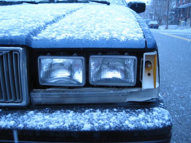

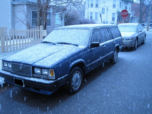

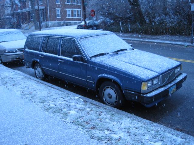

Last night I drove my 89 home from the shop. My mechanic welded 2 sections of exhaust pipe that had holes in it (this car was really loud when I bought it!). He also fixed the power windows and changed the oil. 170 bucks for everything...
Here she is. Quite a beauty..
Right side. The body is in really good shape. It has a leather interior and cd/mp3 player and upgraded speakers. Drives well. Paid 800 bucks
Left side. Body is in good shape
This is the only damage to the body. I'm working on fixing this, no biggie...

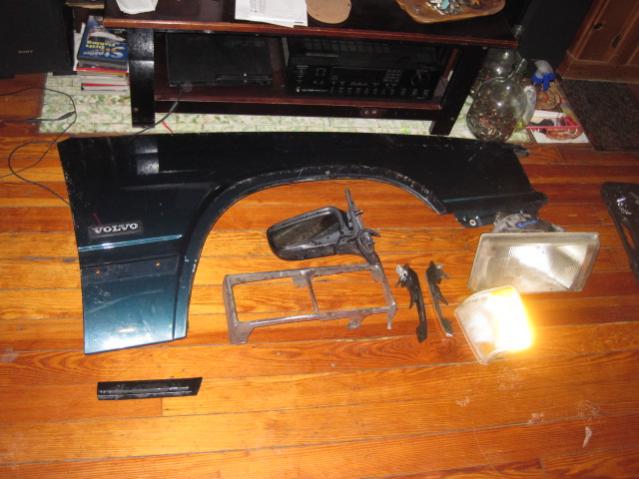

Just got back from a pull and pay junk yard. 2 hours in the snow yielded every piece that I need for both volvos!
91 dollars was the damage for:
I found the trim piece to the 87!
This was the first time I've ever been to a pull and pay. I can't believe they had everything I needed!
