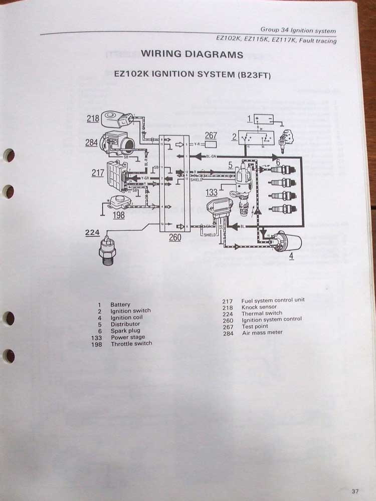

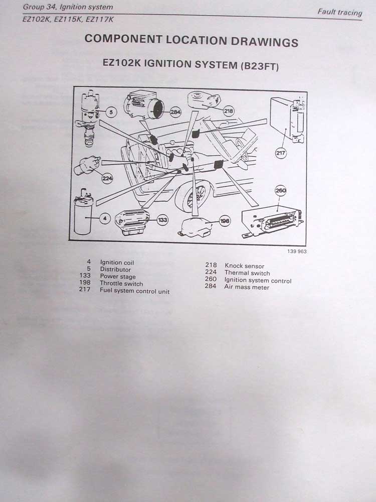

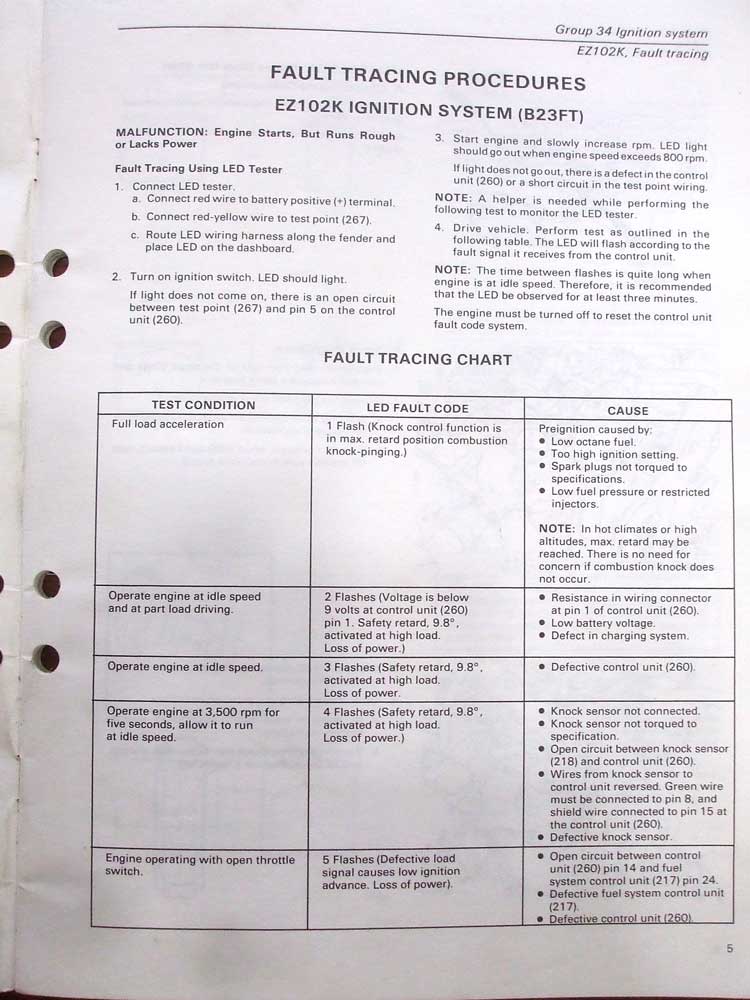

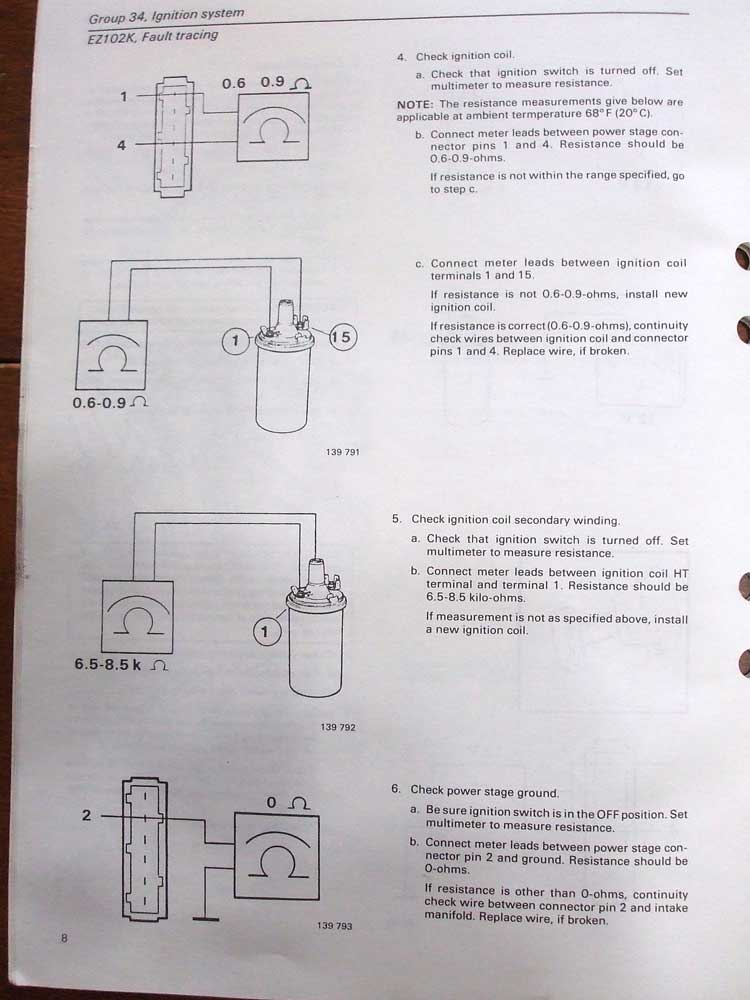

Okay here's the actual stuff I promised. I got side tracked and relized that I no longer have Photoshop.
Below is part one:
Attached Thumbnails 83 240 stopped and will not start-ez102k-1.jpg   83 240 stopped and will not start-ez102k-2.jpg   83 240 stopped and will not start-ez102k-3.jpg   83 240 stopped and will not start-ez102k-4.jpg   83 240 stopped and will not start-ez102k-5.jpg

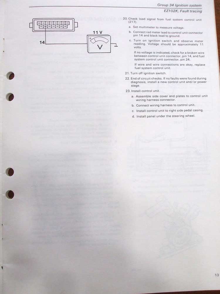

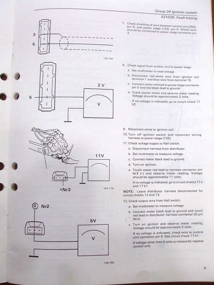

Part 2:
Attached Thumbnails 83 240 stopped and will not start-ez102k-6.jpg   83 240 stopped and will not start-ez102k-7.jpg   83 240 stopped and will not start-ez102k-8.jpg   83 240 stopped and will not start-ez102k-9.jpg   83 240 stopped and will not start-ez102k-10.jpg

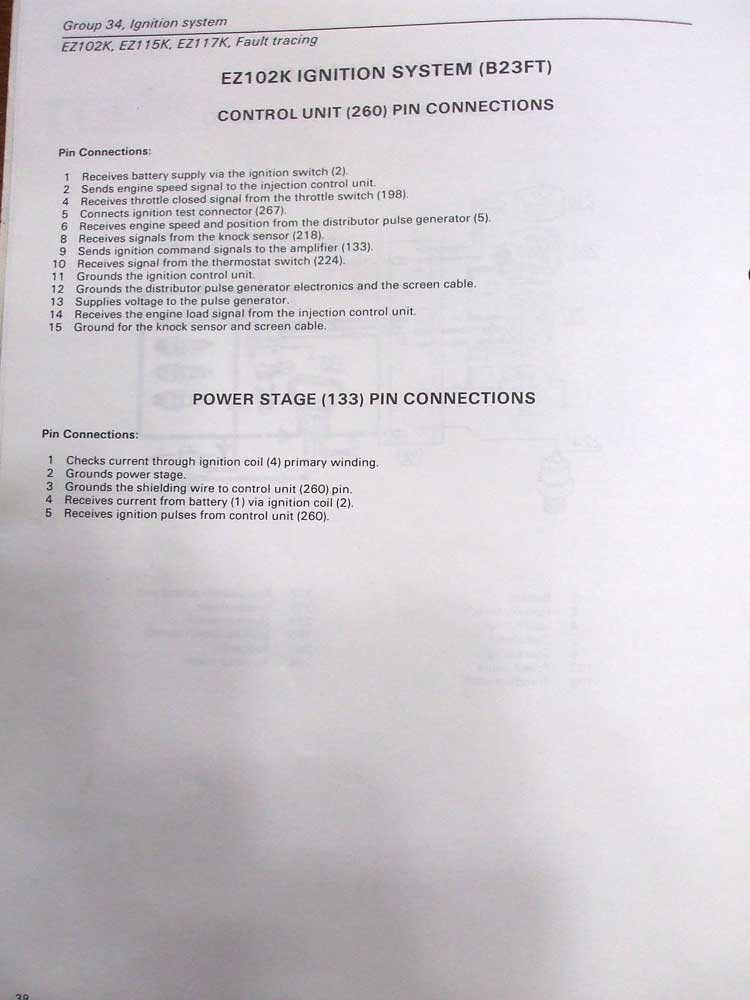

The last part.
Part 3:
Attached Thumbnails 83 240 stopped and will not start-ez102k-11.jpg   83 240 stopped and will not start-ez102k-12.jpg   83 240 stopped and will not start-ez102k-13.jpg   83 240 stopped and will not start-ez102k-14.jpg   83 240 stopped and will not start-ez102k-15.jpg

I also forgot to mention that after looking at some of those manuals on k-jet.org it looks like the hall effect sensor is actually stock, so it's a likely suspect.
This link was the other that I meant to post earlier:
http://www.k-jet.org/files/greenbook...on_systems.pdf
