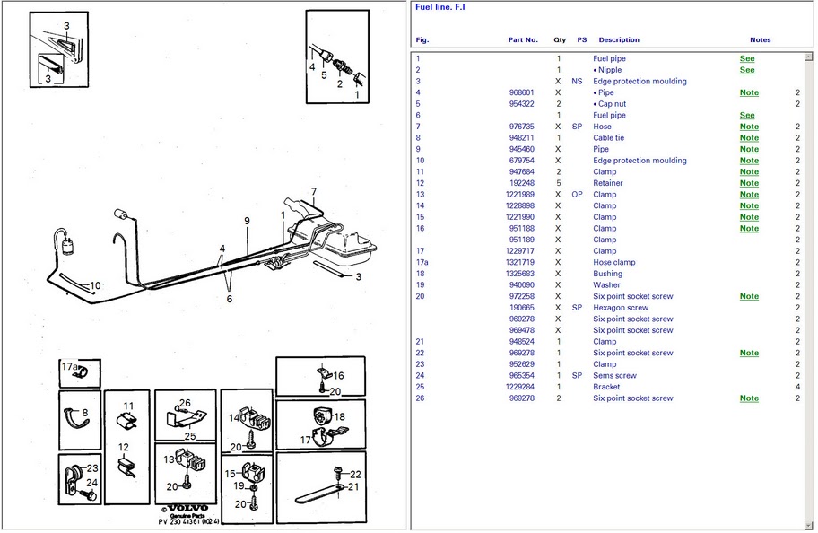

open vacuum line on the regulator would make it think you are wide open.
the gas lines are in the trunk behind the back seat. goes from the tank pump to the filter, through the main pump, to the engine rail to the pressure regulator, and back to the tank.
on this diagram, I think #1 and #4 are the return line/pipe
Attached Thumbnails 85 240 not taking throttle-fullscreen%2520capture%2520040211%2520120824%2520am.jpg
