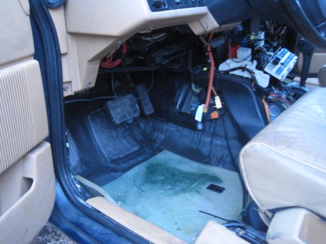

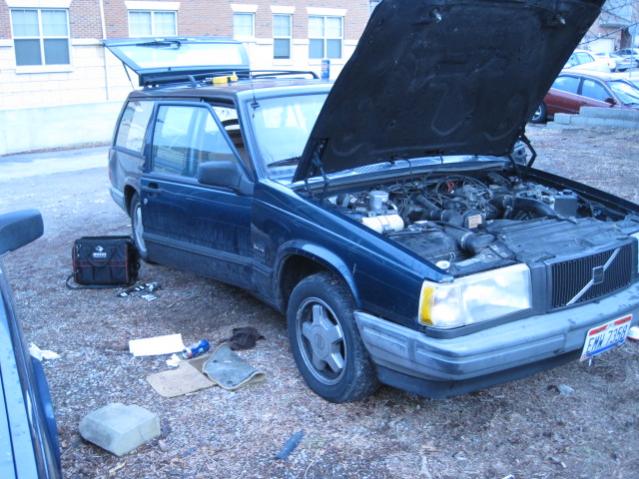

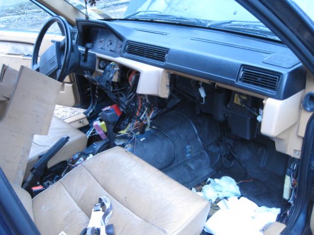

Today I just ripped out most of stuff to change out the heater core. Here is what she looks like
Check this picture out. She's pooling radiator fluid on BOTH sides! I was watching it drip, as I removed various panels. Nasty!
The 89 is in really good shape. I'm about done with the repairs. The 91 needs work, but I got if for 400 bucks. After the work, It'll still be under a 1000 bucks total. I'm really enjoying, learning how to fix these cars up. I'll keep everyone informed as to my progress. I don't plan on making these cars super nice, just want to keep them road worthy for cheap.

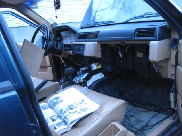

I finished replacing my heater core (and flushed the coolant system) yesterday! Today I bled the system and drove it Heat, defrost, and temperature control all work. No leakage in the interior.
The job took me about 15 hours, over 4 days. I took my time and drank a lot of beer throughout.
It was a pretty easy repair because I followed my haynes manual and these two guides:
http://www.volvoclub.org.uk/faq/Heat...eplacement.htm
http://www.volvoclub.org.uk/faq/Heat...eplacement.pdf
I highly recommend these if you want to replace your heater core and don't know how. The second link PDF is really helpful, as it has many pictures. I hope it's not against the rules to post links to other forums, if so then my bad...
Here are some pics:
First Pic, my car all tore up. The heater core was leaking on the bottom left corner.
Here it is all put back together. I did not put the carpet back in. I have rubber mats down. I may pull some carpet at a salvage yard and install at a later date..

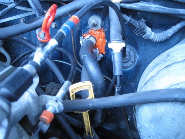

The only problem I had was the new heater core did not line up with the holes in the firewall foam seal. I had to expand it with a drill bit and knife. I used high temp RTV to seal the opening. Hopefully it holds.. Swiftjustice (thanks) assured me it's not a big deal if its not 100% sealed.
