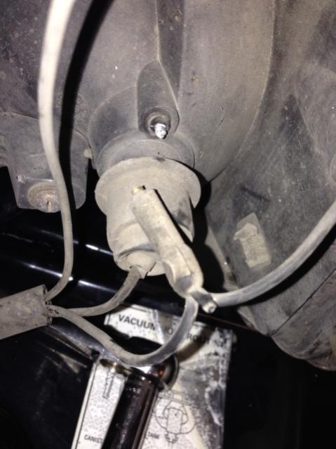

** Update **
After finding lots of tail light wiring issues with bad grounds I decided to take out the front grill and light assembly.
Basically the socket which serves as the ground had a broken connection.
Attached Thumbnails 90 240 Front Passenger blinker not working-turn-signal.jpg
