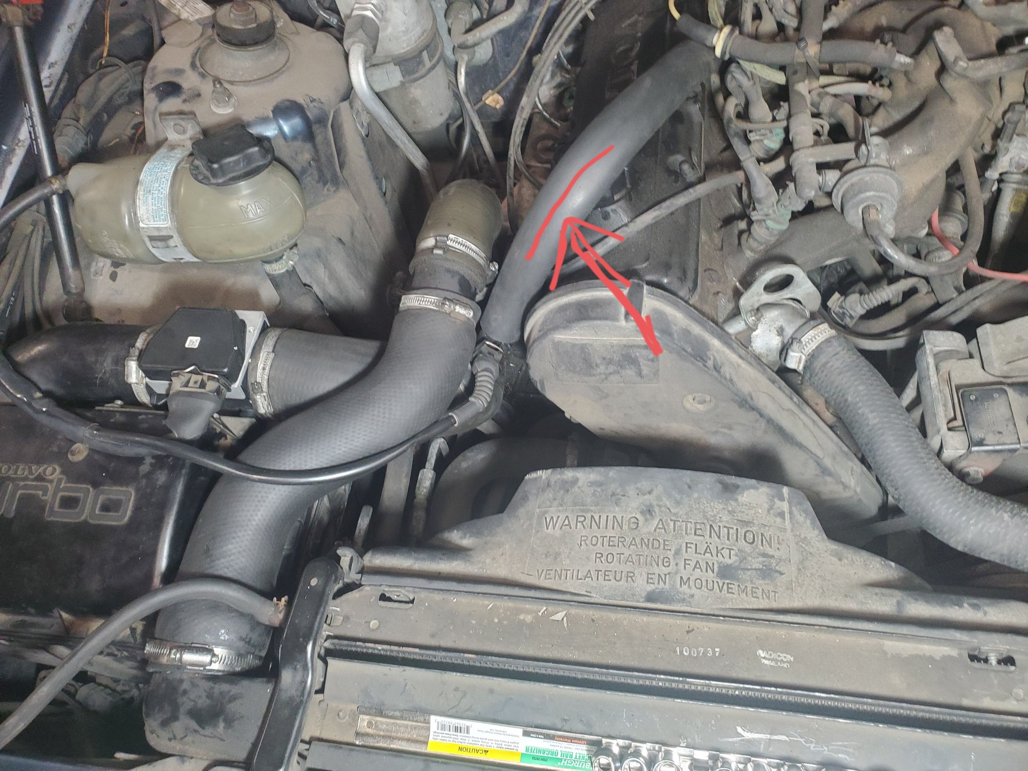

I swapped the old mafs in and rechecked all the hoses again.This rigid hose is the only hose that is not clamped
I noticed that the white hose marked in red was dangiling next to a barb on the connector for the black hose so i plugged that in. Tried starting it and after 30 sec at idle it bogged and stalled. Un plugged it and the same. Wouldnt even drive. Swapped the new sensor back with the white line plugged in and it was back to yesterdays issues with it being drivable but bogging when the turbo needle hits white on the dash board and then idle jumping up and down at the stops and occasionally stalling
as to your question lev i got a blue streak mafs from orileys autoparts.

So, return that MAFS, obviously it's bad (common), and get another one somewhere, even a used one. Did you clear the code from before, did it come back? I think the MAFS is the problem.
