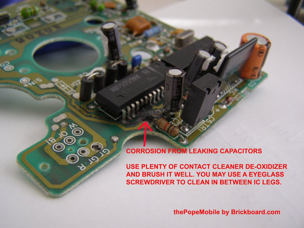

Hey Pierce, are the chips the 2 black, rectangular objects in this pic?
Old Nov 16, 2016 | 10:21 AM
oh wait.... never mind, the Yazaki speedo on the 91/92 740/940's uses different chips, not the UAF2115 that was used on many VDO speedos :-/
