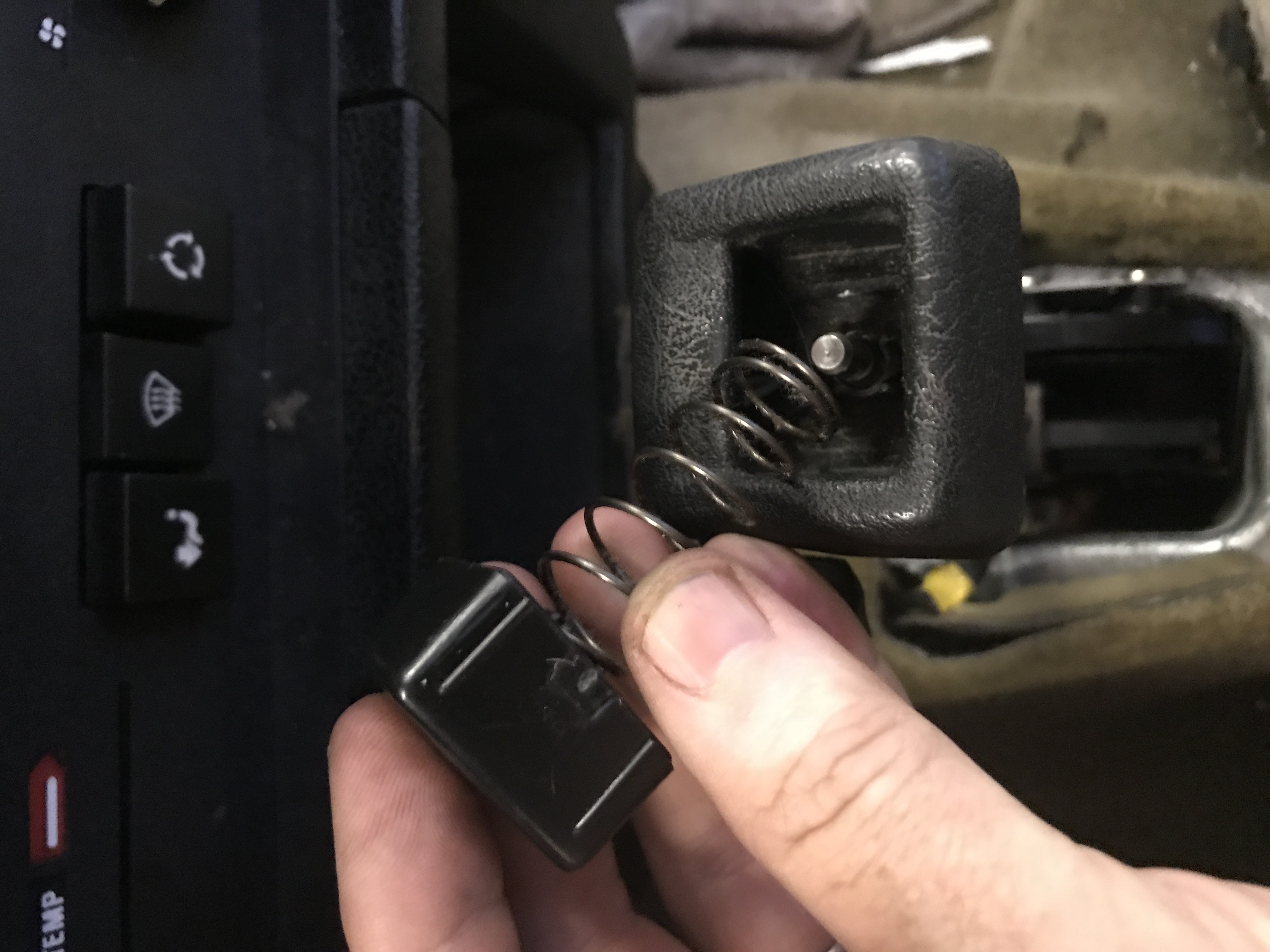

Daughter's car wouldn't start due to a floppy shifter. Turns out the 3 retaining screws were gone from the bottom of the shifter bucket. Quite the pain getting that bucket out and replacing those. I thought the hard part was over, but now I can't reassemble the shifter correctly. The top button stays depressed, I can't move the shifter out of park and the car won't start. I'm doing something wrong and I can't figure out what it is. Would love some help!
Attached Thumbnails 93 245 AT - Need help with shifter reassembly-img_0253.jpg   93 245 AT - Need help with shifter reassembly-img_0252.jpg   93 245 AT - Need help with shifter reassembly-img_0251.jpg

a 93 probably has a shift interlock, which is a solenoid that is actuated by the brake pedal, so you can't take it out of P unless your foot is on the brake... there's generally a button or something to override the shift lock, I remember on my 740, I could stick my finger into the rear end of the slot the shifter is in, and lift up on a 'hook' that would release the shifter so I could shift into N or whatever even if the car wasn't switched on.
anyways, your pictures don't really show enough to begin to guess whats wrong. here's the parts catalog diagram of the shifter from a 92, note the solenoid I describe is part #51 (highlighted).
