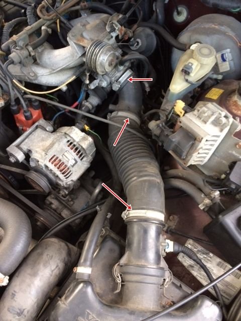

So I rechecked the "paranormal voltage" phenomenon. I'm including a photo with arrows showing where I'm getting voltage readings. Mind you, the meter jumps around, but on these hose clamps, attached to the air intake and not touching metal anywhere, I'm getting readings from .25v to in some cases over 4v. I checked other locations under the hood and get nothing. Any ideas? This seems nuts to me, but I'm thinking it could have something to do with my intermittent issue.

Where do you place the other end of the probe? One on the clamp, the other? I have the same car but a '94. I will do the same test, just tell me where you place the probe.
Old Jun 11, 2021 | 05:22 AM
2Small2Fail's Avatar
Joined: Aug 2016
Posts: 117
I've got the meter set to 20v DC setting, putting the red lead on the hose clamp, the black one to ground, somewhere on the block. Here's the weird thing: it doesn't seem to matter if the black probe is touching anything; I still get a reading.

I am no electrician but it seems to me that you have a faulty meter. A lead not touching anything should not produce a reading... may be I am missing something? I doubt that even if those mysterious readings were correct that would have anything to do with causing stalling. I'd suspect a MAFS causing your issues but you don't have one in this car, it uses the pressure sensor which rarely fails but you may want to test it:Regina Manifold Air Pressure (MAP) Sensor. The Regina fuel injection system uses air pressure and temperature in the intake system to compute the air mass moving into the engine. The MAP pressure sensor is located on the driver's strut tower support. It is connected to the intake manifold through a hose and takes a reading of intake pressure. The sensor is piezo-electric and changes a voltage input to an output signal proportional to manifold pressure. The system calibrates atmospheric pressure when the engine is started and under full load conditions. To test, turn ignition "on" and test the back of the sensor connector or the pins on the back of the ECU connector (do not disconnect with the ignition "on"):

As far as the mysterious readings: it only occurred to me to check because I got a mild shock from a clamp - a clamp nowhere touching metal.
Disregarding the mysterious readings doesn't change that. I checked other clamps on other parts and got no reading at all. Anyway, I wasn't necessarily thinking this had anything directly to do with causing the car to stall, but it is something I'd like to understand and solve if possible, as it means something very strange is going on and WHO KNOWS how it might be affecting things? I will test the pressure sensor as you recommend and report back. The main issue with testing in this case is the intermittent occurrence of the problem.

I'd share your curiosity. It's just that a clamp tightened around a rubber hose should not have current, rubber isolating electricity is a pretty major tenet of physics and engineering, etc.
