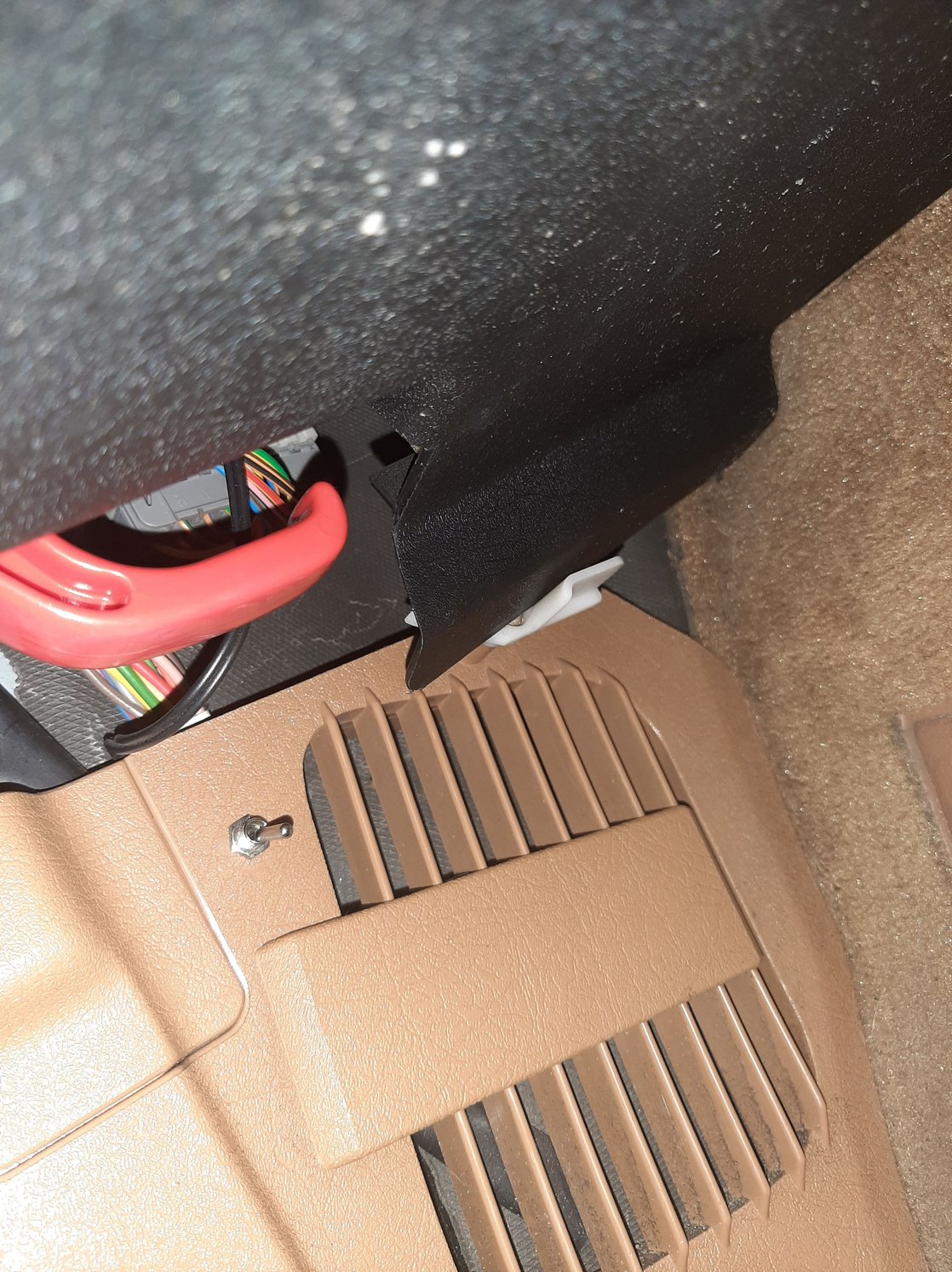

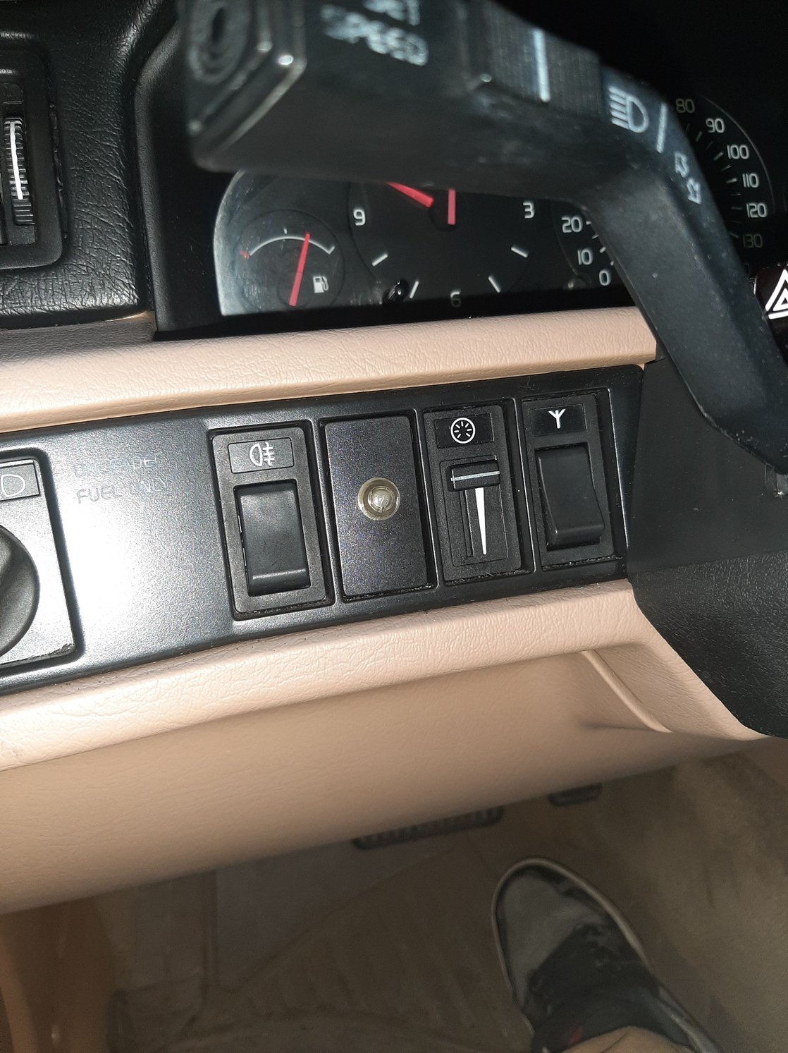

Hi all. Recently purchased a 1994 940, which has has some strange switch installed, and a light on the dashboard. Switch looks wired up with no noticeable difference in vehicle, and the light has never lit. Any ideas on what they could be?
The unmarked light is between the dimmer slider and fog lamp switch. Ive never noticed it light up,but it is wired.

It's an aftermarket alarm set up, now not connected. The toggle switch was to be flipped on to deactivate the alarm, enable a start. There is probably a siren inside the engine bay. There was a separate fob that went with it, it might have had remote locks function. You can go under the dash and look for the module, get the make and model number and order a new remote if it's still available, depends on the age of the system.
