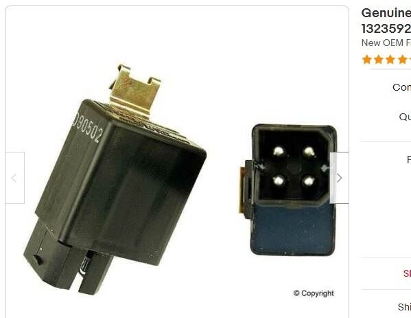

The problem could be:
Fuel system relays develop cracks in solder joints on the relay circuit board. Those cracks create resistance, which creates heat, the board expands due to heat and those cracks become an open circuit. Fuel pump shuts off, car stops. Relay cools down, connections make contact again, car starts and runs until problem repeats.
A 940 should have a black noise suppression relay under the hood that can do the same thing. That relay powers the ignition/fuel injectors, and was placed under the hood rather than with the other relays - to avoid radio interference.
