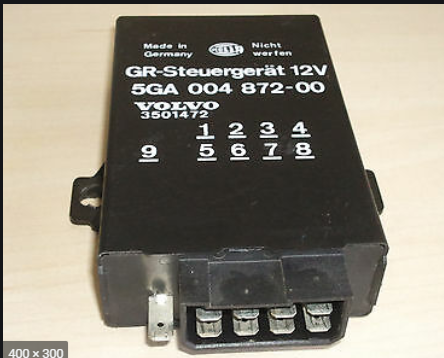

The main unit is VOLVO 3501472. It has two connectors. 1 with 1 wire and other with 8 wires. For the life of me I could not figure out how the 8 wire connector is supposed to come loose. I did not want to break it. If someone knows how to remove it, please tell me. My idea is that with connector removed, I could somehow test the vacuum pump? it has 3 wires coming from the unit. Of course how to test it, if someone knows that?

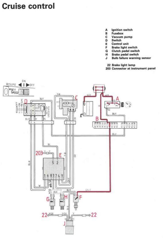

is this a regular 940 (gl, gle) or a 940SE ? the "SE is really a 960 in many ways but has the 4 cyl turbo motor. I suppose with a manual its almost certainly a base model 940.
those cruise control units often crap out with age, they are fairly analog and capacitor values drift and just stop working right. anyways, here's the diagrams from the 1991 940 greenbook. any wires shown as RED are hot when the switches are set in the position shown.

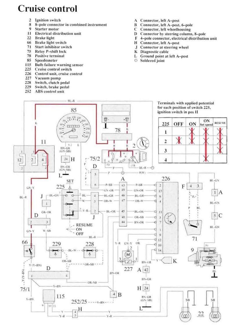

Pierce, thank you for that. Mine is GL i believe, imported from sweden. fuel injected 2.3 non turbo, m45 (button 5 speed) gearbox.
That is the same 1994 wiring diagram that I found. But that is for different main unit, it has more pins than mine. Mine has only 9 pins. I believe that in 1993 when they added the B box to the LED fault indicator, they also added the option to diagnose the CC system. And that needed another CC main unit that HAD the option to diagnose. And B box has a pin for it. But mine 940 is so old, it has no B box, only A box.

Ok, then it seems that there were different versions available? Because mine has 9 pin connection to the CC ECU. Heres image of the ECU

hmmm, the 9 pin cruise control was apparently used on 240 and 740's.... I do not ahve 740 diagrams (other than the 91/92 model years that were essentailly the same as 940), but I do have 240's and indeed, the 1990 240 (year picked arbitrarily) shows a 9 pin, like this...
