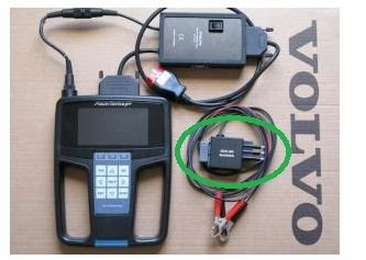

Yes you need a scan tool that talks to ~1987 to 1998 Volvos like one of the three models pictured. You should be able to find a 1996-1998 compatible tool. 99 and up use use a different communication protocol.

I have a VST my shop used that reads all ~1987-1998 Volvos. Different software cartridges are swapped when needed. The OBD1 codes come out in a text form on the ~1987 to 1995 cars. Those cars use the 6 pin adapter clrcled in green (alligator clips to + and - on battery) to add a obd2 port under the hood. 96-98 plugs directly into the obd port in the interior. Supposedly able to calibrate the c70 convertible tops until 2004 with it also. It's for sale if you know someone interested!

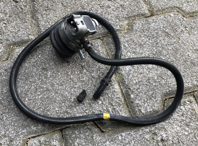

This appears to be the culprit, or one of many. I assume this is the EGR solenoid, and the end of this hose connects to the EGR valve. It got brittle, and fell off when touched.
