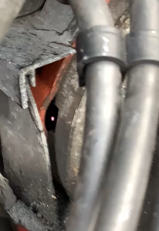

Also noticed that I can see into the distributor through a little gap and see it sparking, is this normal?? Surely that would just let water in very easy, but I took it off and it seems undamaged and looks identical to a replacement (its a bosch one).
I've attached a picture of it.

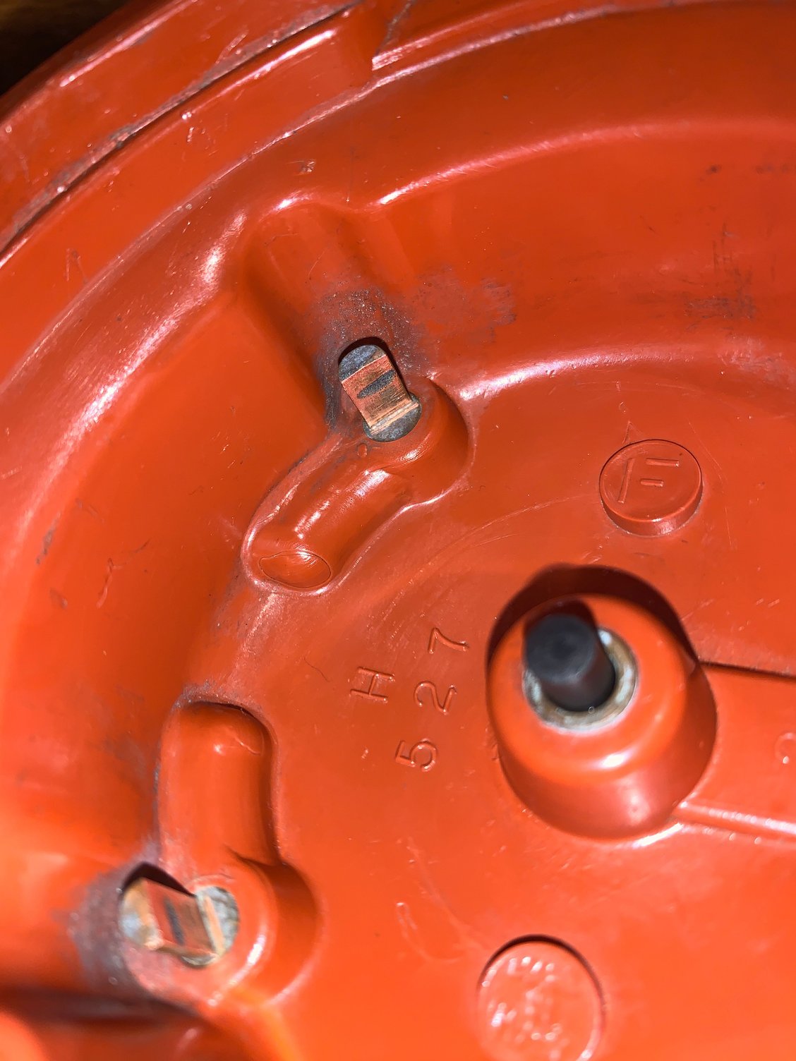

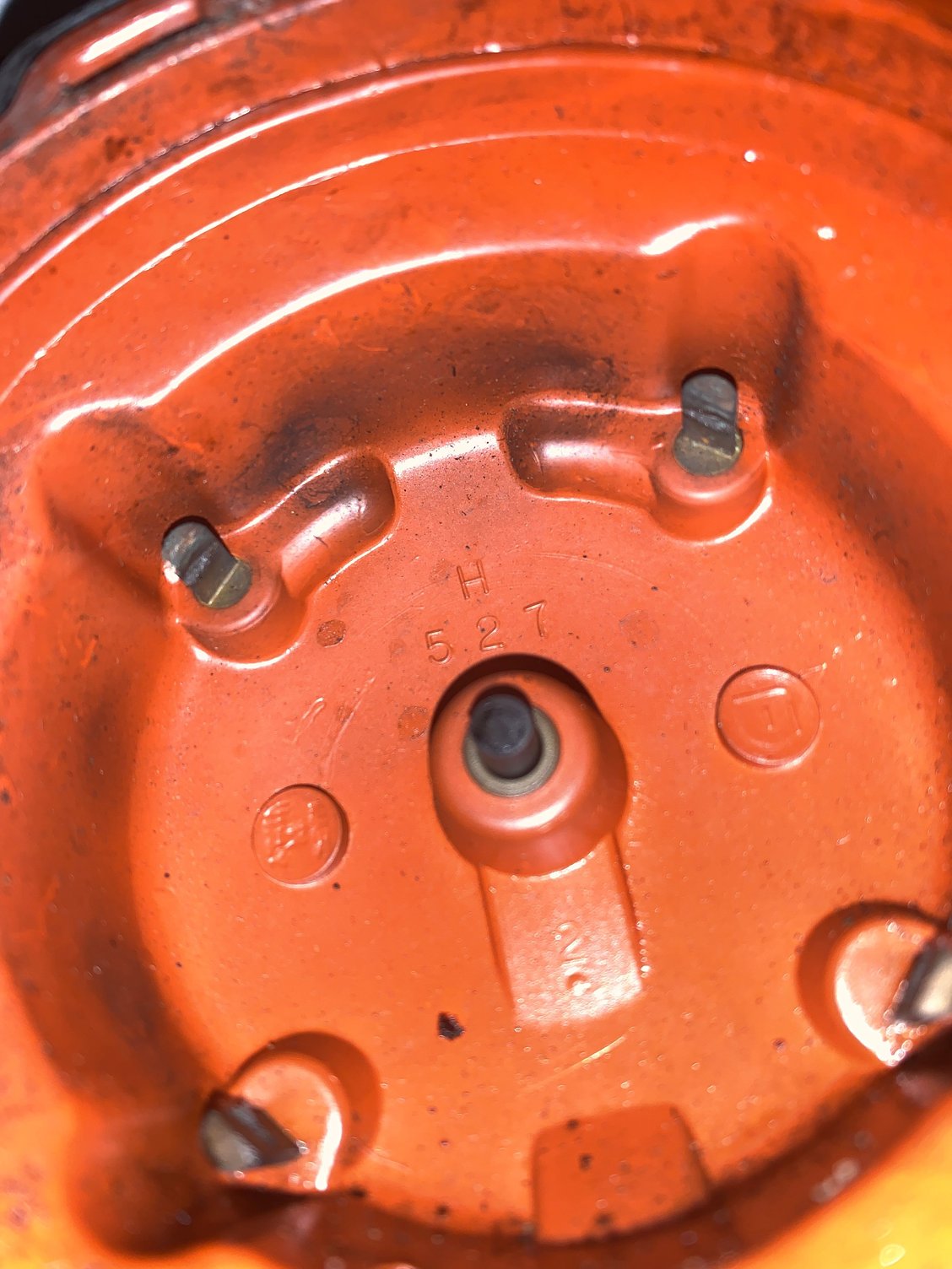

Took the distributor off and the contacts had lumps on them they'd corroded that bad, so sanded them clean until I can get a new one and that seemed to have solved my issue.
I know now I should have probably checked that first, but whatever, I learned a lot by fiddling with everything else
dirty
dirty
need a new one but will do for now
Still confused on if I should be able to see into the distributor as I can't find any info about that.

yes you can use emory cloth or fine sand paper to clean the rotor and cap contacts. My suggestion is if the car is new to you also check the date codes on the wires - if over 5 years go new wires/plugs/cap/rotor. Also inspect the connections to the coil and battery posts. clean and tighten as well. As to plugs, go OEM - older engines with single coil ignitions can't really use newer plug types so stick with copper core and make sure they are properly gapped and the correct part# for your engine.
