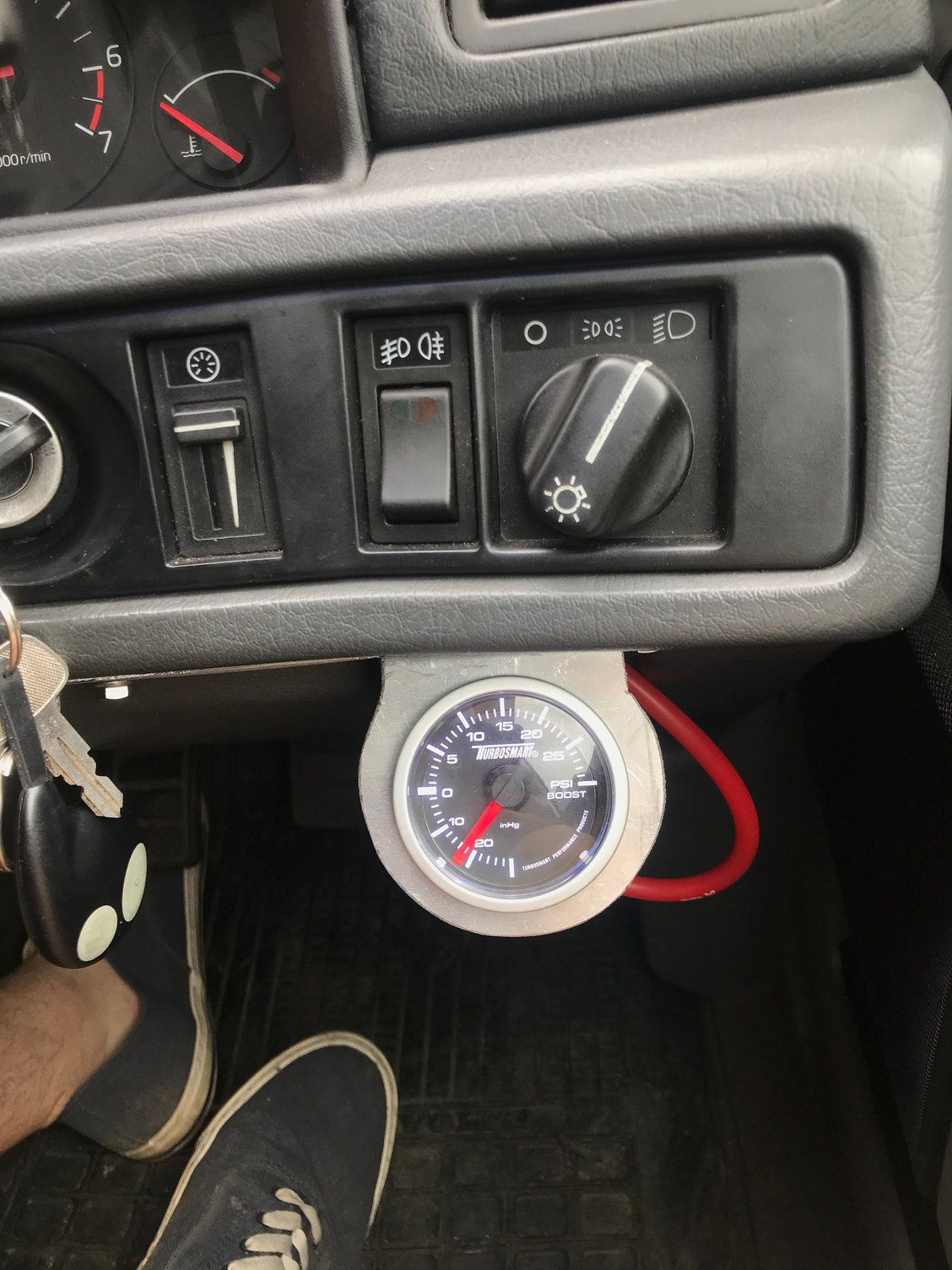

I’ve installed a boost pressure gauge and idling at 1000rpm it shows negative 20psi, if that’s enough vacuum I don’t know what is.
The best part about it is we’re talking about a 97000mile example, it’s mint inside and out. The cam looks golden and brand spanking new, it’s looks like a really healthy engine yet it does all this.

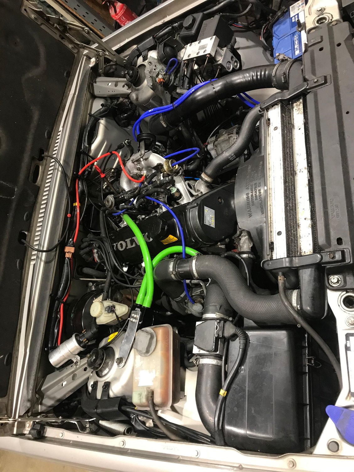

the green pipes are the pcv to intake via a catch can.
the red line is the boost gauge signal.

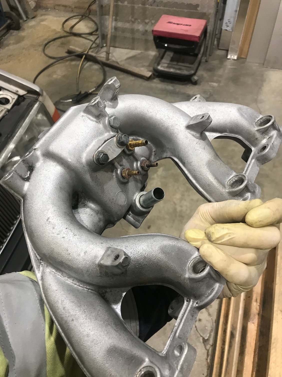

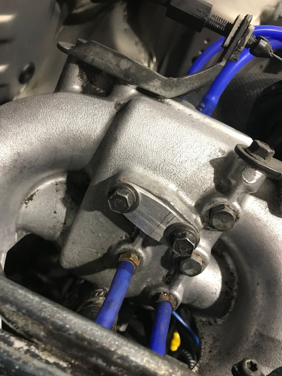

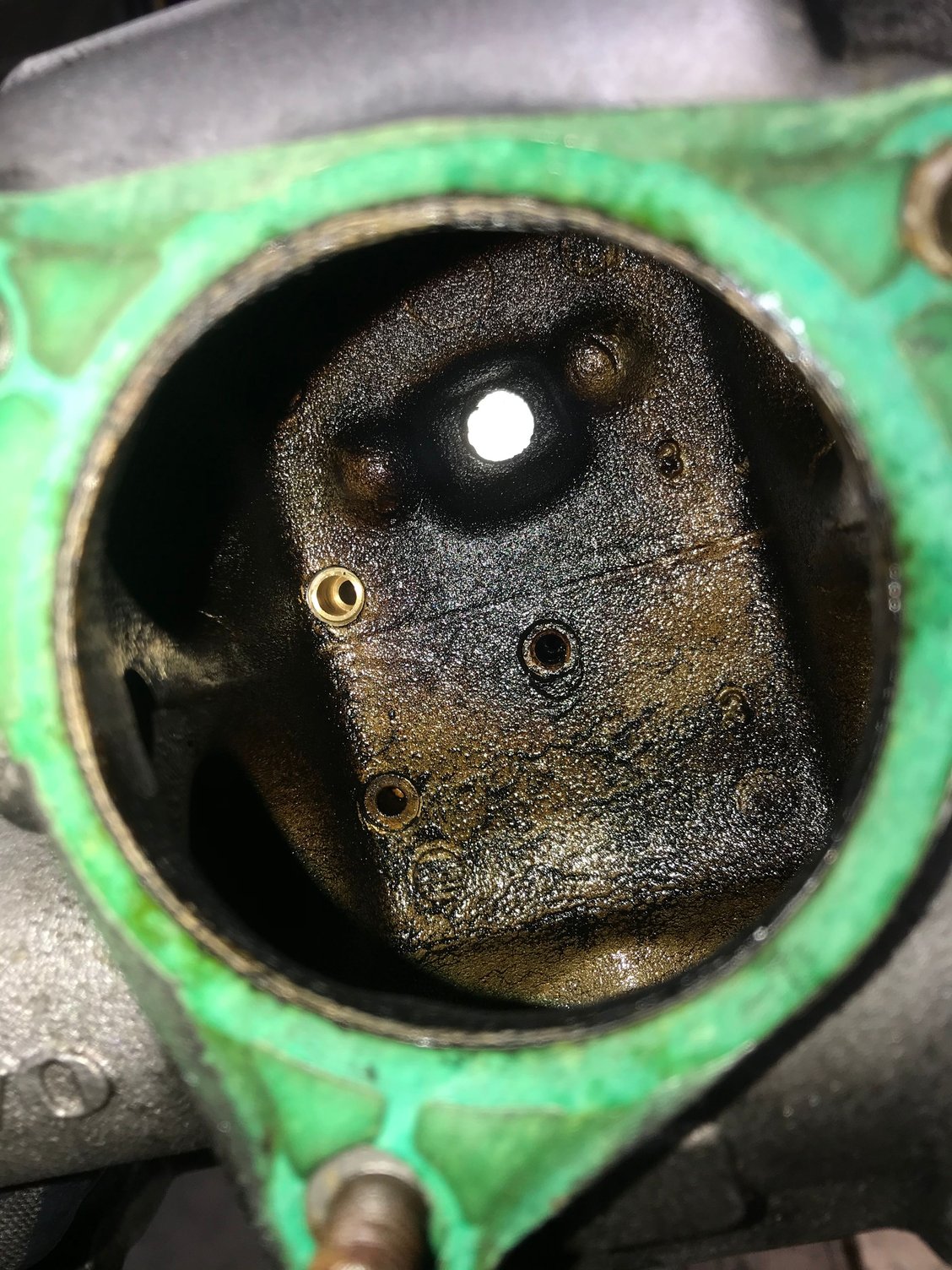

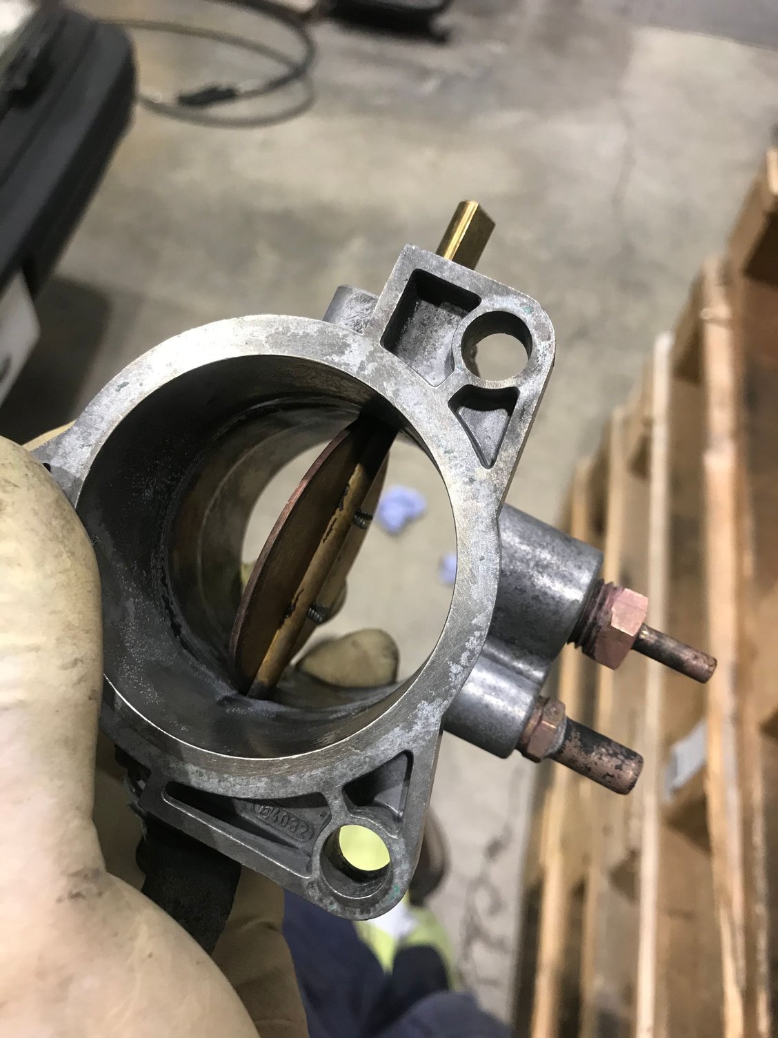

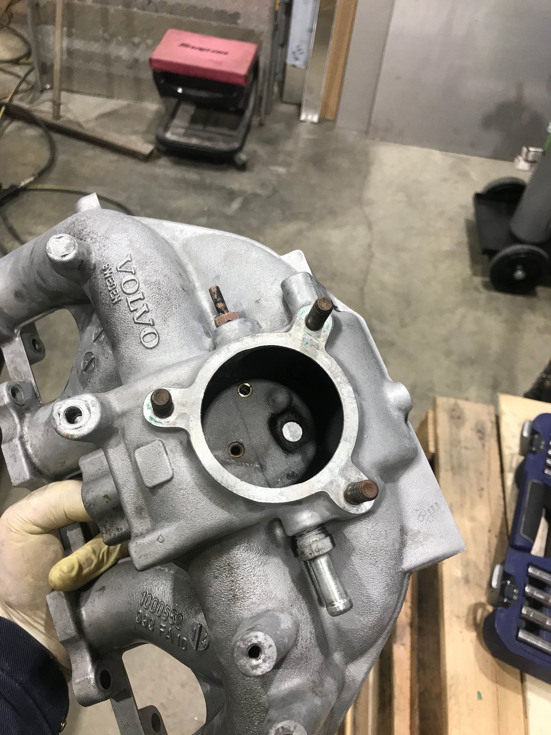

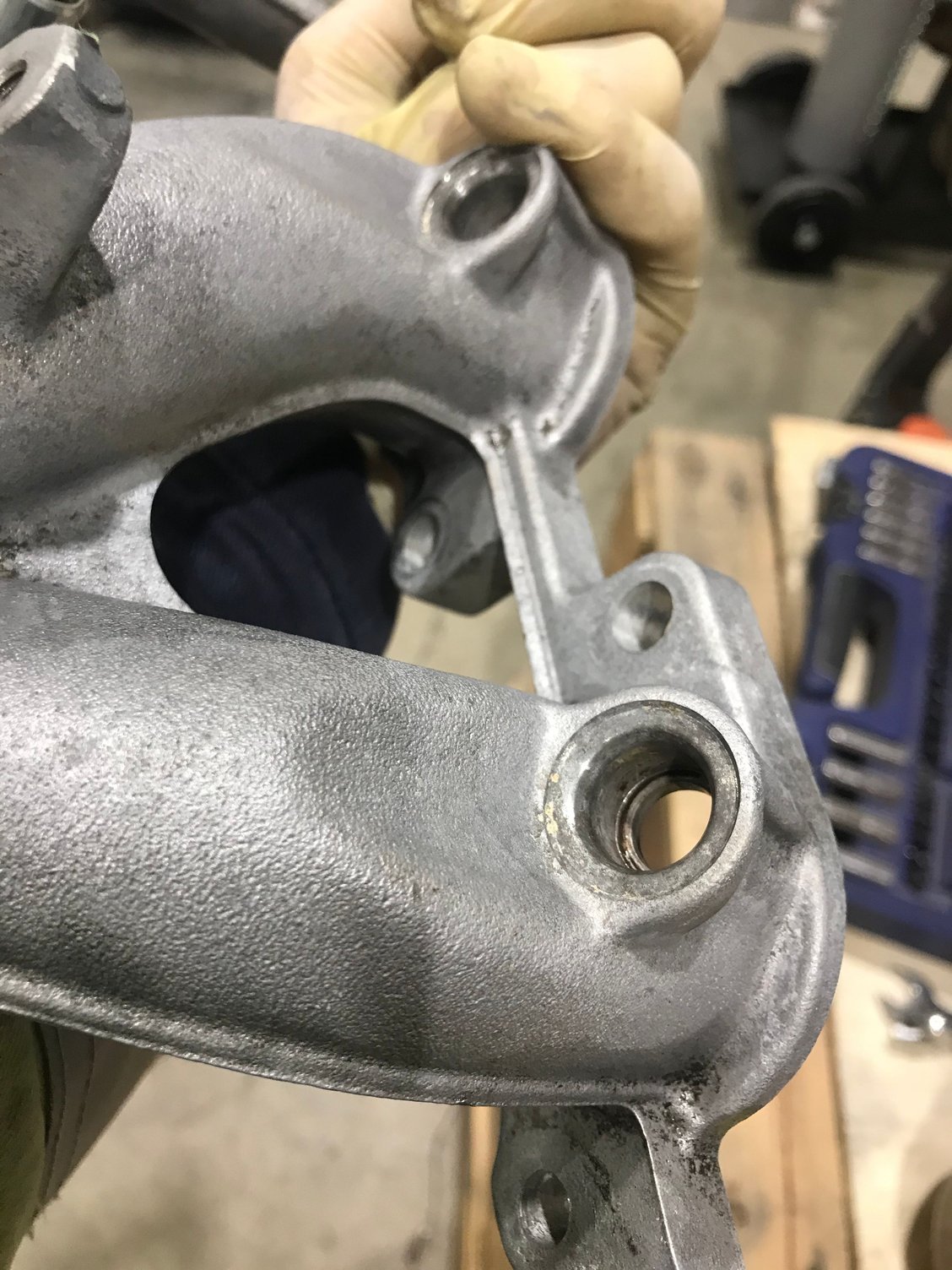

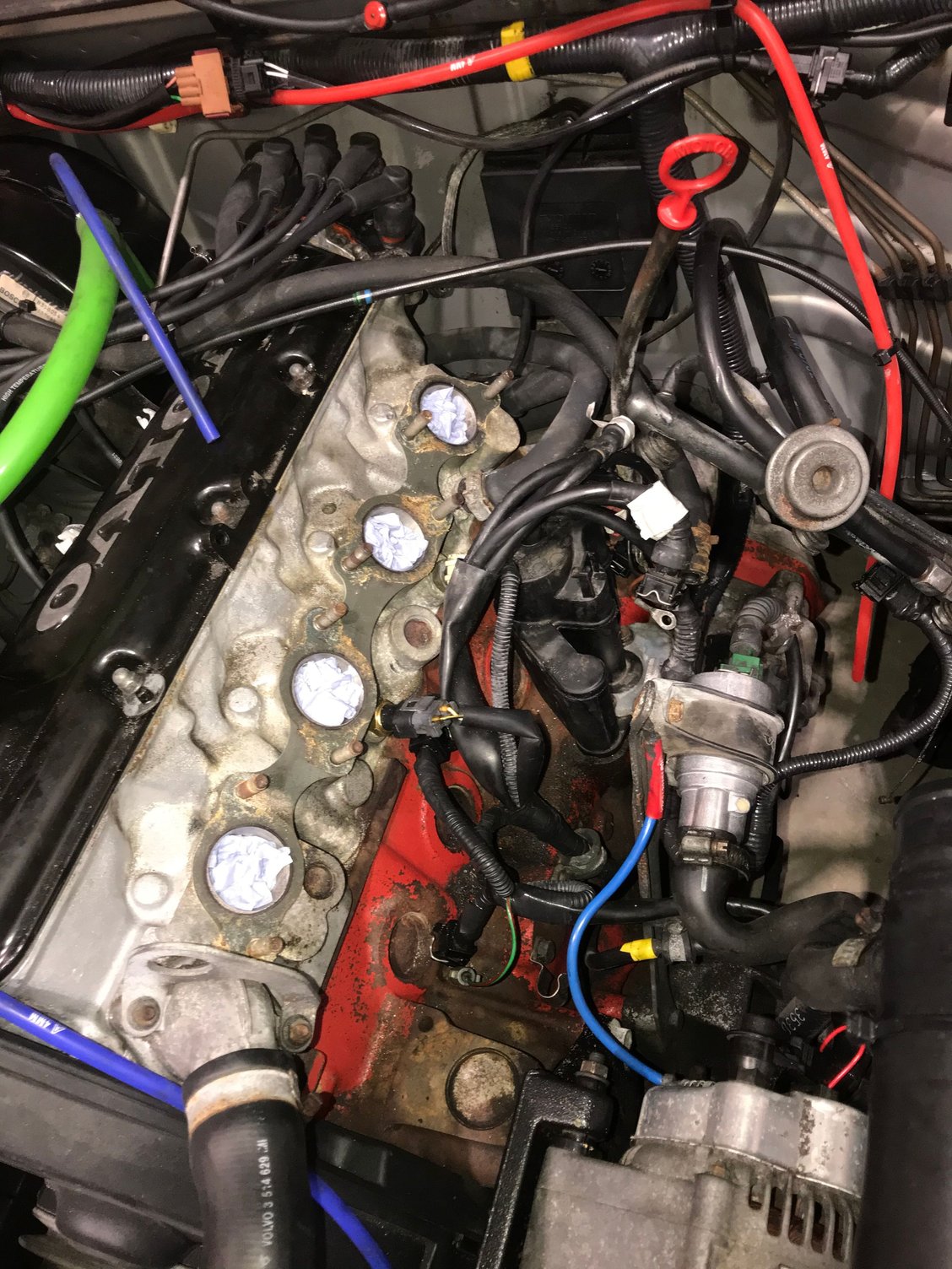

Just had the entire manifold of and torn apart, cleaned it inside out along with the throttle body and all the vacuum fittings and holes.

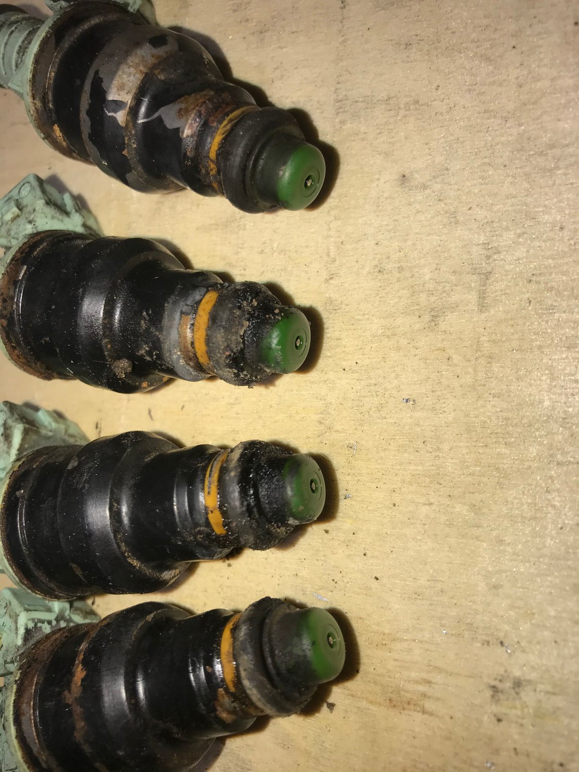

Removed cleaned and re installed the injectors and the seals.
all hoses and pipes seem to be in acceptable condition. Injectors don’t seem to leak however they didn’t fire whist off the manifold, the car however did start once re installed. The idle is still high, 1000/1100rpm I’ve still not driven the car as I’m waiting for the gaskets to cure a little more.
