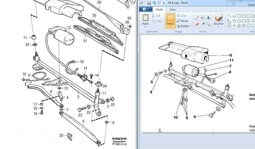

So I recently had my wiper linkage break on my 1996 940 wagon and I was able to replace it with an old 740 linkage because the part was essentially the same. However, when I got it all set up and running, I noticed the pegs that the wipers attach to rotate counter clockwise instead of clockwise. So I had to attach my wipers vertical, and when I turn them on intermittent they go down then up and hold vertically until their next pass.
Any ideas on what could be causing this and how to fix it?

The wiper motor arm (#4 in the left picture) is installed 180 degrees off. Take wiper arms off. Turn wipers on turn off, let them park. Take #4 arm off and put it in the correct position so the arms will be down when parked.
