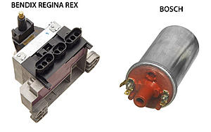

The Bosch systems will have the soda can style ignition coil while a Regina has a box
Check the rotor
check the ignition
also check the main relay

So the "Regina" system can be fuel and/or ignition?
Old Sep 29, 2017 | 03:22 PM
Regina fuel injection is generally mated with Rex ignition. I've hear dof cars that had Regina injection with Bosch ignition, so all sorts of weirdnesses are possible.
on the injection side, Regina uses a MAP sensor, while Bosch LH uses a MAF/AMM. These are quite different.
