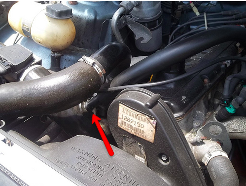

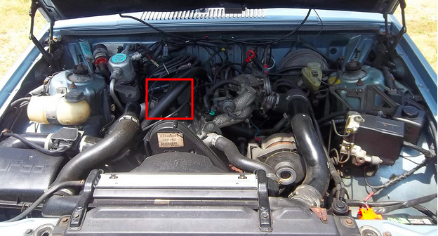

Wow what a great resource. Thank you for the link. After reading around in there I have the idea that my turbo bogging down could be related to a leak in a hose.
I had a look under the hood to try and find a loose hose and this is what I found...
The hose that I highlighted does not have a clamp on either side. I can remove and replace it very easily with just my hands.

Here is a close up of the side closest to the front of the car.

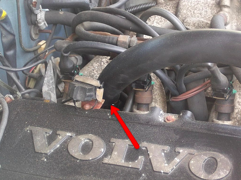

... and here is the other side. Note the the hose kind of covers the part that connects but hopefully you get the idea.
Any idea if that not having this hose clamped on could be the cause of my problem? What the name of the clamp/hose is so I can buy them? I am currently tracking the fuel mileage so I am not sure if I am getting what I should. I should know that in a week or so. I really only drive a bout 50 miles per week but since I got this I have been cruising a little more
Thanks again for the link and any ideas would be appreciated.

Old Jun 4, 2011 | 12:21 PM
that 1" foam covered hose that comes out from under the intake manifold and crosses over to the intake hose between the AMM and the turbo is the crankcase ventilation. I'm not sure it being disconnected would cause the symptoms you describe, but, when the turbo is sucking hard, it could certainly allow some air into the system that hadn't gone past the AMM, causing the EFI to underestimate how much gas is needed.
That end in your last picture end goes to the oil trap on the block under the manifold. Note that hose is actually a plastic pipe that has a foam cover (why? I dunno), the cover ends a bit before the end of the pipe.
since your problems start with positive boost pressures, I'd be looking for holes/leaks in the air plumbing AFTER the turbo.... My 745T had a severe power loss at full throttle high RPM which turned out to be the intake hose on the output side of the turbo being improperly clamped and under high boost was letting too much air out. but in my case, this caused the turbo boost needle to flap wildly as the power cut out.
