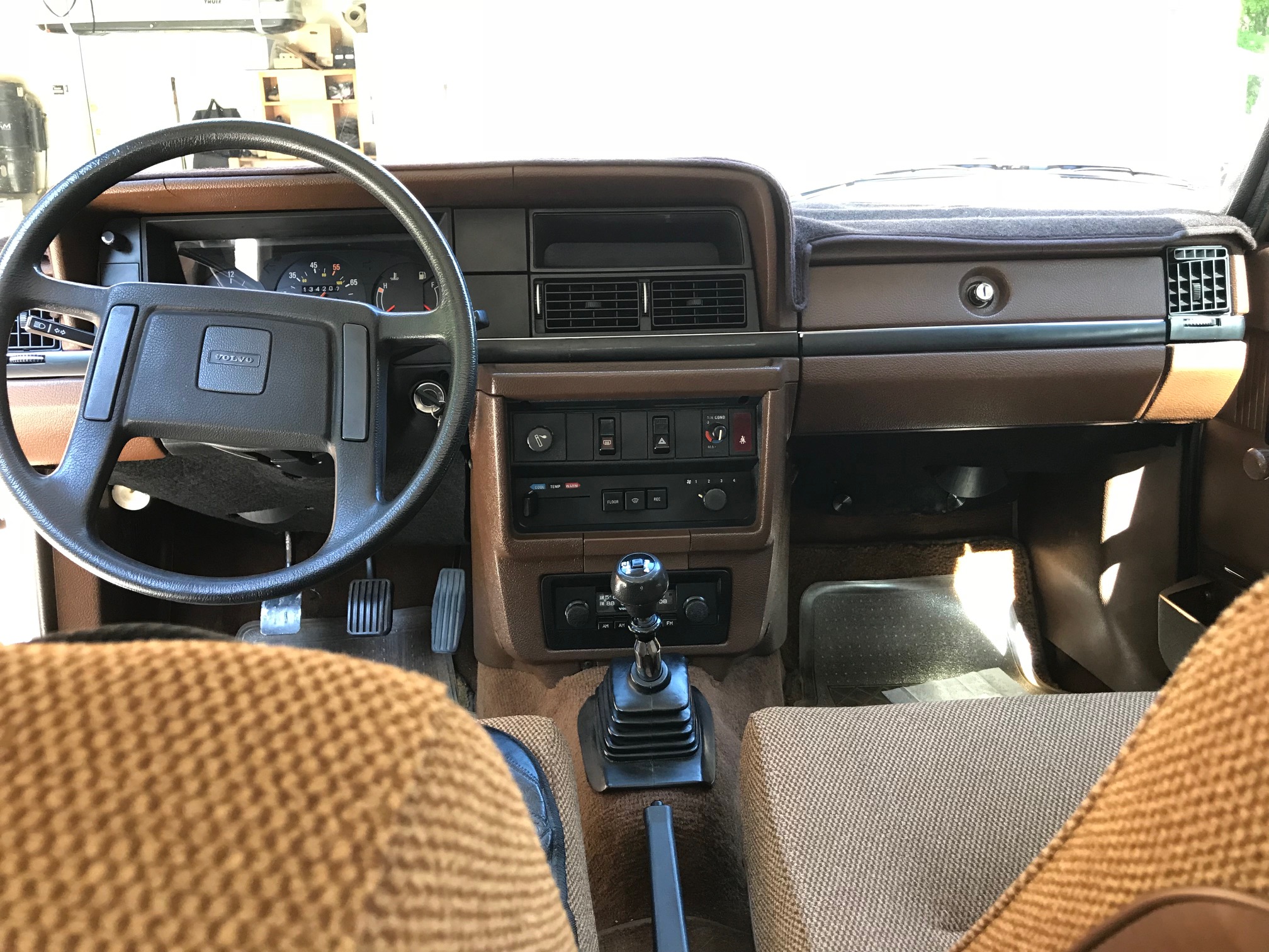

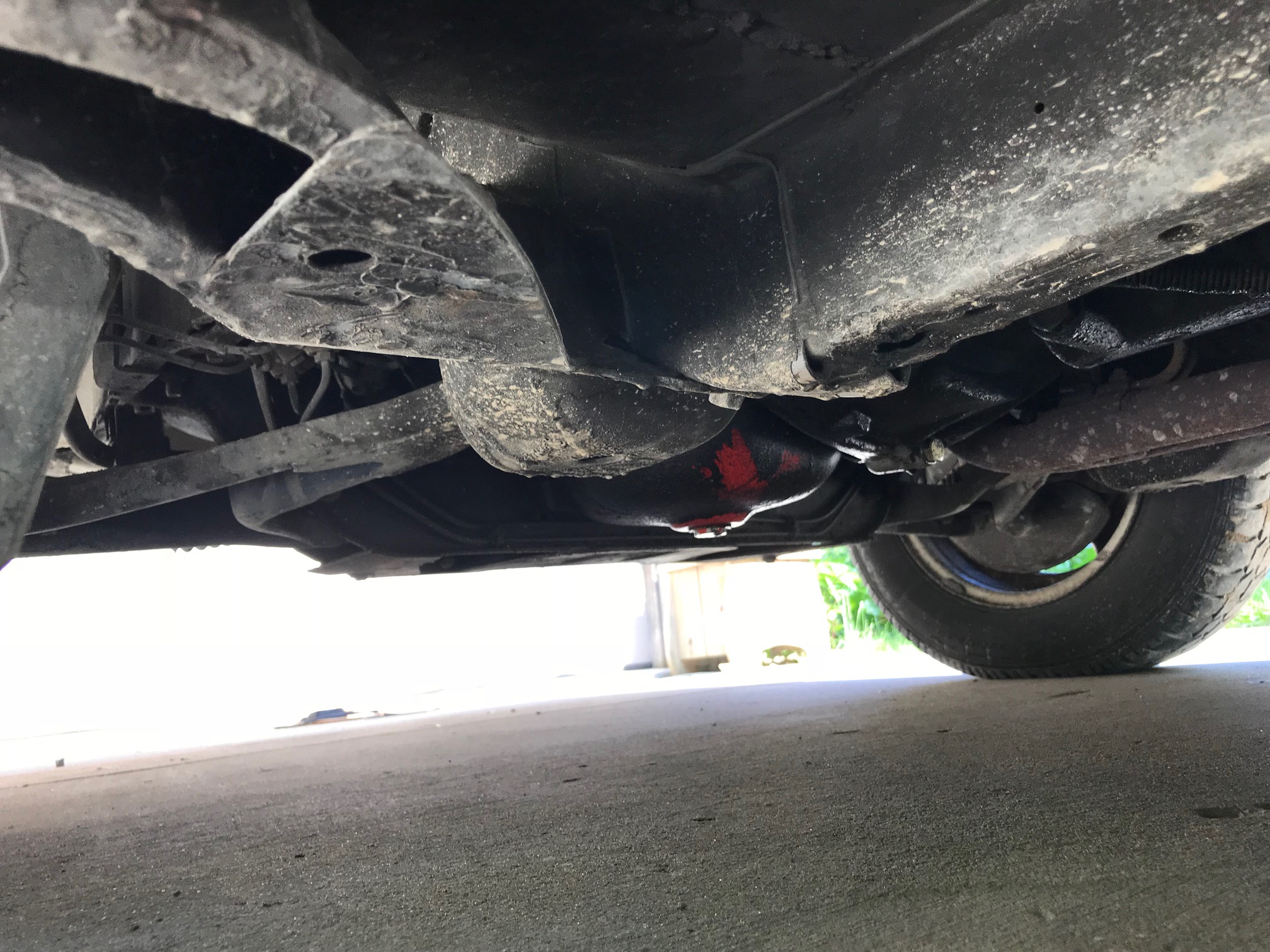

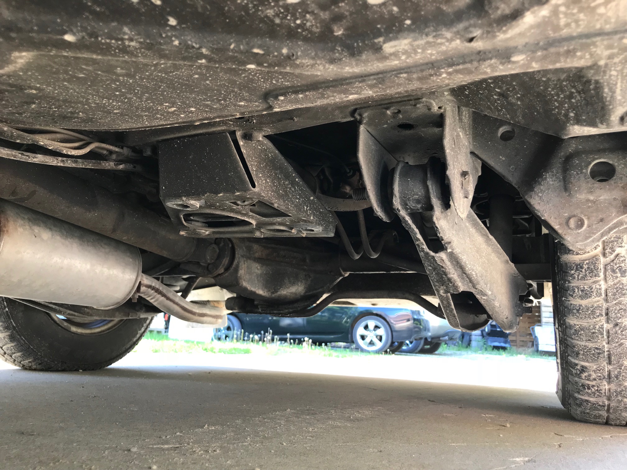

So I am new to the Volvo world and have agreed to purchase this 1982 244. It has 134,000 miles, odo still works, AC works, paint is original, as is the whole car. Spent most of it's life in California but has spent the last 6 years north of Green Bay. No rust! The owner will be delivering the car to me in a couple of weeks and I am really excited to get to know this car and begin tinkering!

Nice looking car. What did you end up paying for it?
I would keep it all original, even the old radio. Maybe swap out the clock for the correct Tach. And she needs a clutch pedal pad. Give her a good buffing and waxing the help protect the paint. I love those rims, trim rings and center caps.

Two new pedal pads are already ordered as well as everything needed for a complete tune-up.
