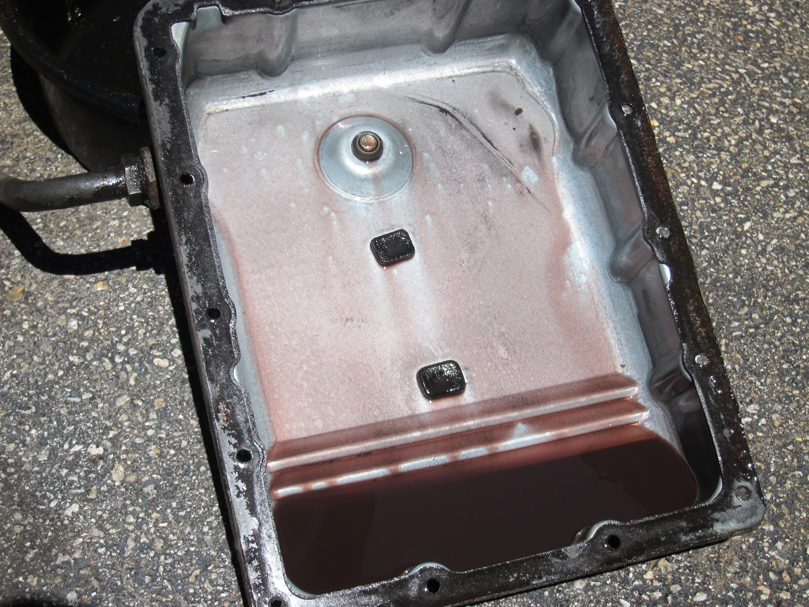

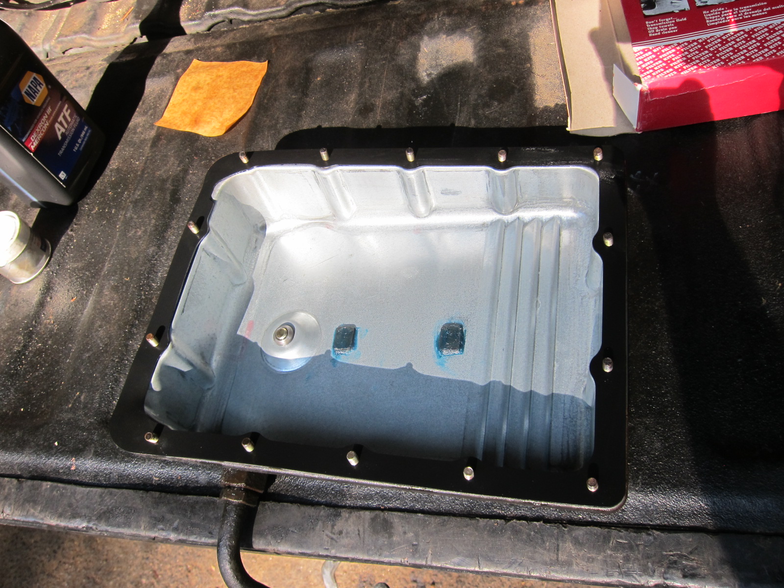

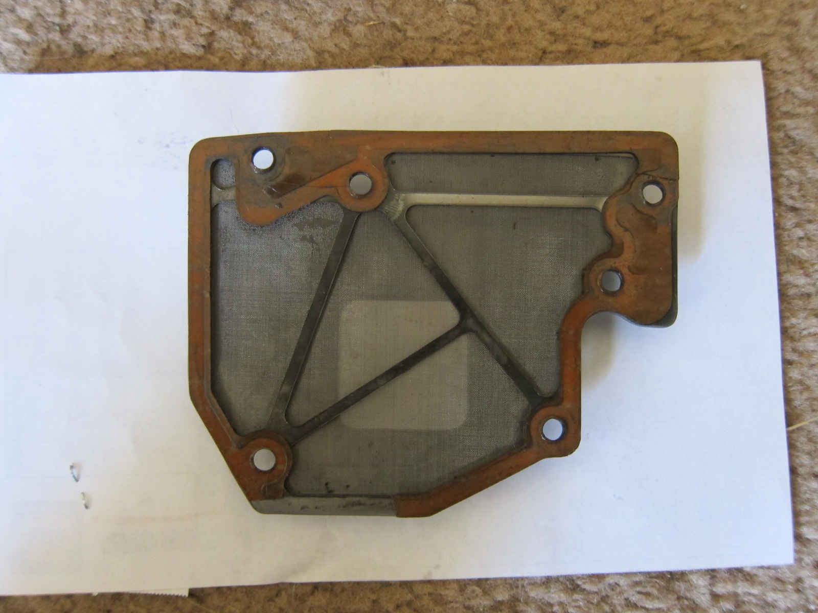

I flushed 11.5 quarts through the transmission last Friday. I've since driven it 143 miles, and dropped the pan yesterday to change the filter. Was really surprised at how clean the pan was given the color and smell of the fluid! Not bad. Was going to just clean the screen, and re-install, but of course, I caught the edge of the gasket accidentally and busted it off. Not going to reuse that now, so might as well just get a new filter and be done with it.

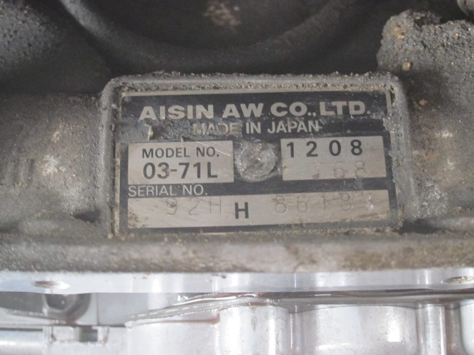

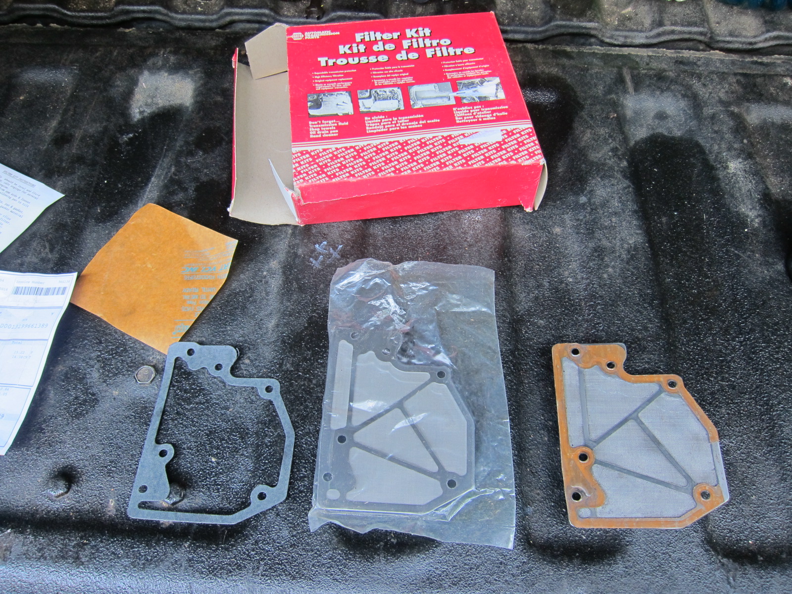

Tranny is a AW-71L according to the side plate (see pic). But, I ordered a cross-referenced Wix filter off RockAuto, and it was wrong. Went to the local NAPA, waited a day for it to arrive, and theirs was wrong too! Luckily I brought the old filter with me on the 2nd trip. The counter guy looked through pics on his computer - said it's a AW45 (if I recall correctly) filter for a Toyota! Go figure. Of course, the only filter available is 200 miles away. Perfect.

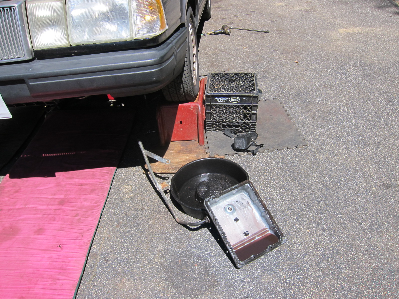

Anyway, I'll update this thread when the new filter gets here Thursday. For now, I'll post some pics of the job for those that may be interested, and see who here has run into similar issues.

This had nothing to do with where I'm shopping. The transmission takes an AW-70 filter even though it's stamped as a AW-71. Very odd. I would've run into the same issue no matter where I went, unless it was a dealer that ran the VIN. This here is the exact filter I just removed and installed. See pic of my tranny plate in the post above:

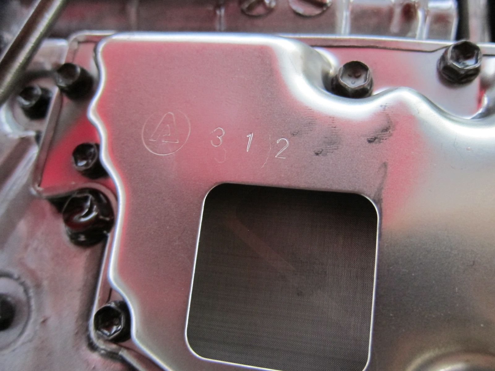

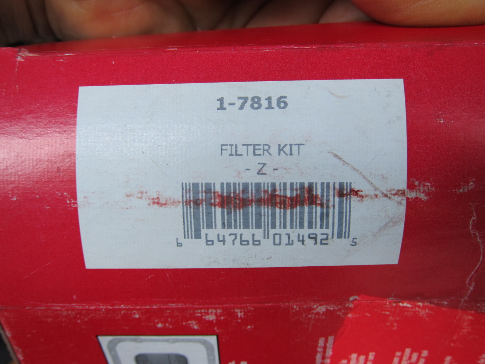

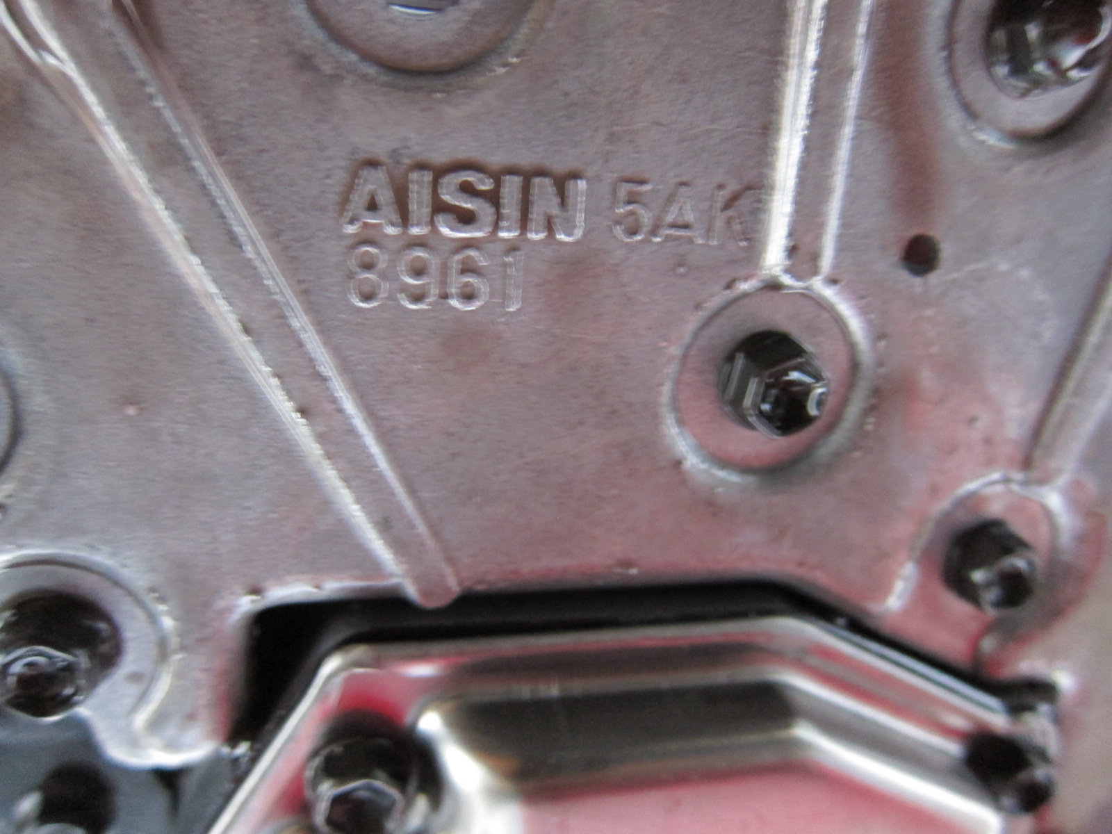

Anyway, the Volvo is back up and running. I snapped some pics of the box, the new filter, the NAPA part number, and the numbers on the valve body, if that tells anyone anything. Alot can happen in 23 years. Maybe someone put an AW-70 valve body in this thing? Maybe it was done at the factory? Who knows. All I know is, this job will be 200x easier the next time without all this running around!

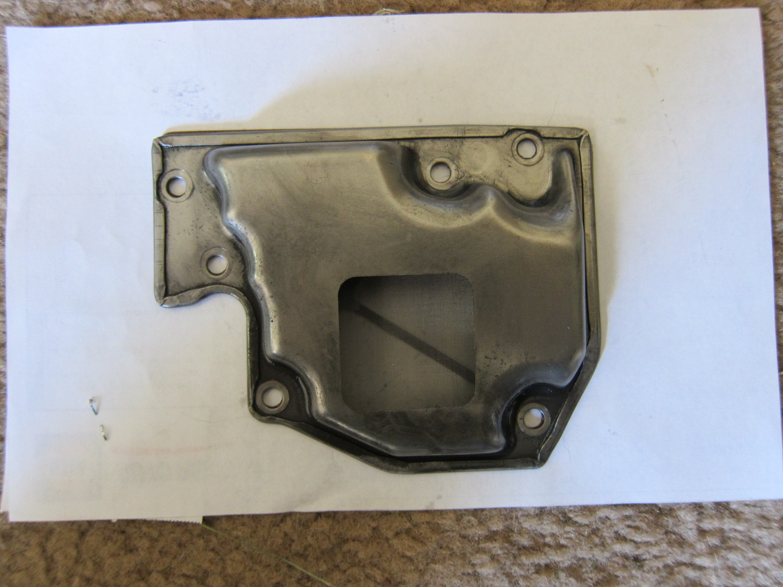

I closely inspected the replacement filter - was identical in every way to what I had removed. No signs of poor quality. Screen was identical too. Plus, got a rubber gasket instead of the cork one I removed.
