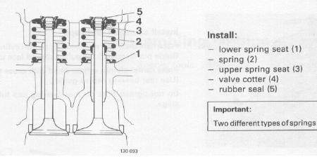

Ok I did some more reading and I heard changing the valve hushers might help. I called my Volvo dealer and they did not know what that was but they sent me a picture.
Can anyone determine which part is the valve husher descibed in this article is
http://www.brickboard.com/FAQ/700-90...TipRubberSeals
Old Sep 30, 2009 | 12:20 PM
bubba240's Avatar
Joined: Mar 2008
Posts: 734
it's number 5 in the attached picture ... hopefully the dealer can find the part number.
Attached Thumbnails Bought a 1991 Volvo 240 4cylinder 2.3L with 154k miles that has some lifter noise-valve.jpg
Old Sep 30, 2009 | 12:46 PM
umoms's Avatar
Joined: Sep 2009
I got the part number. Its 35144332 Of course none of the dealers stock them. Any ideas how long it should take to replace all 8?

probably about 2 hours, You have to remove the timing belt, or at least take it off, remove the valve cover, remove the cam, pull the buckets, and then reverse put it back together.
