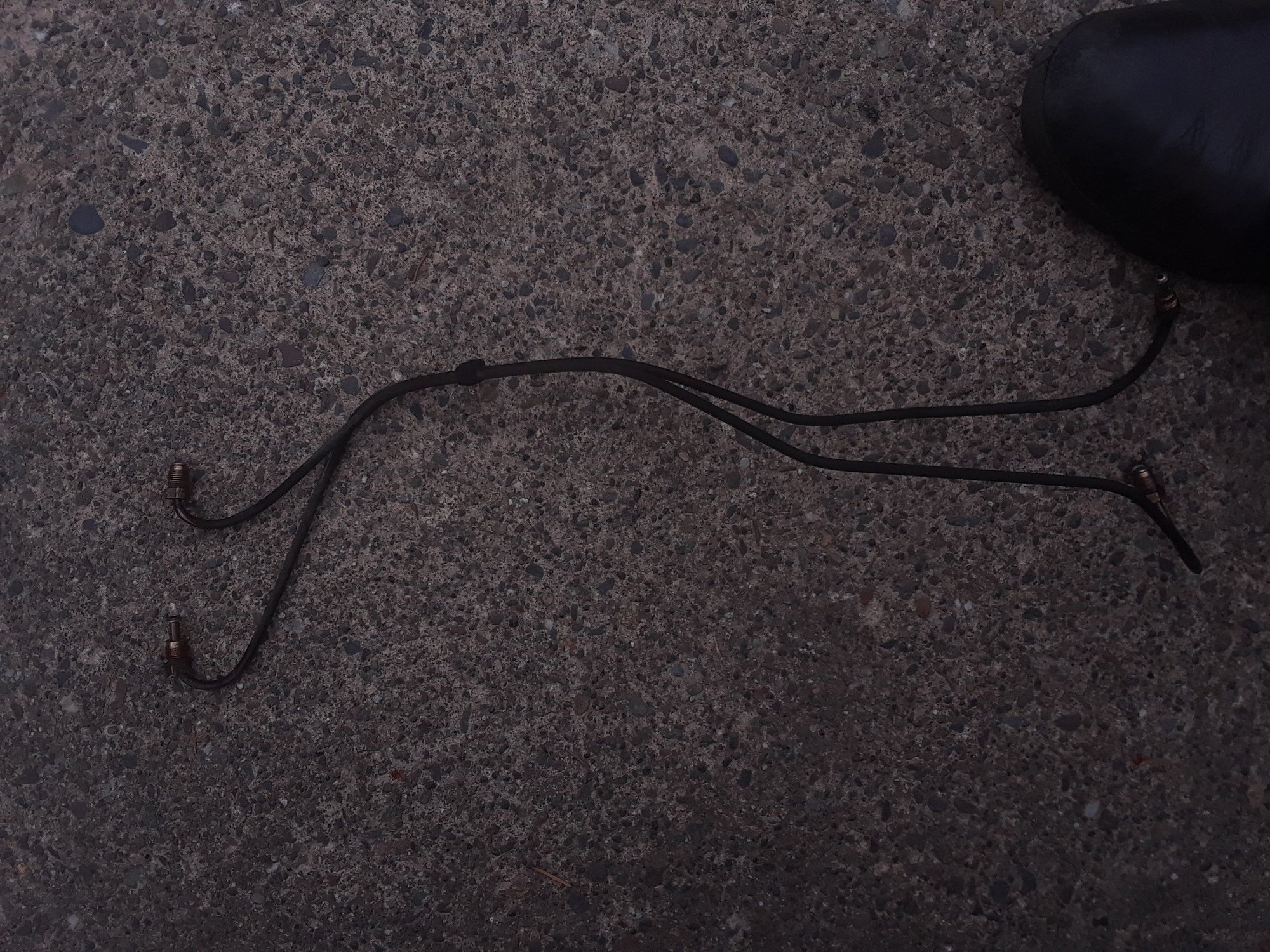

Open the hood and break loose the two fittings on the master cylinder. Unscrew the two fittings and completely REMOVE the two BRAKE LINES connecting the master cylinder to the junction block. This will open access to more fittings down at the junction block.
Photo 2 shows the two lines to the master cylinder removed.

Photo 1 Unscrew the fittings connected to right front.
Photo 2 Remove the two lines from the Master Cylinder.
