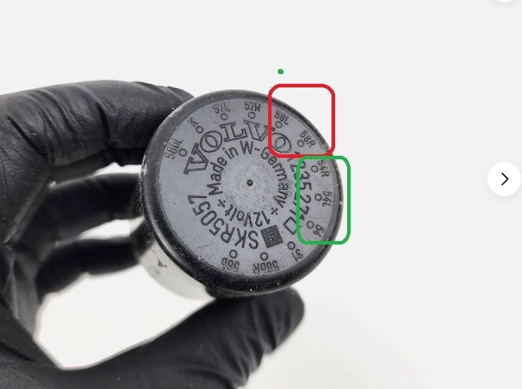

Old Feb 12, 2024 | 08:51 AM
Originally Posted by Laj77
I’m leaning towards the bulb failure sensor but I don’t know how to diagnose
Power goes from -
Brake light fuse
brake light switch
bulb failure relay - should be able to find the wire from the switch at the relay - (It should be the same color)
and then the 3 wires that go from the relay to the 3 brake light bulbs (sorry don't have a wiring diagram, but it's pretty obvious)
I have seen cracked solder joints in 240 bulb out relays - and fixed them with a soldering iron. The terminals (in and out for each bulb out function, park, low beam and brake) are clearly marked, and the cover easily prys off exposing the insides.
