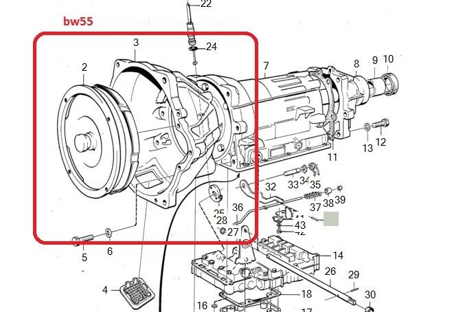

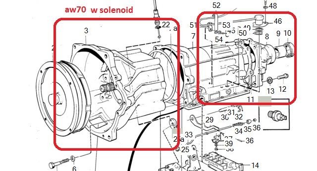

The AW/BW 55 transmission is a 3 speed transmission. If you want 3+ overdrive you need the longer aw70/71 (with a solenoid on the left side of the transmission and the longer bellhousing, the shorter driveshaft, shorter shift linkage, and try to get a speedo gear that reads close. The diff ratio is different in a 3 speed car)
To answer your - what activates it question - a button tells a relay to send power to the solenoid. When the relay goes bad (or wiring or any other fault) you simply grind a grove between the 2 oil ports in the solenoid to allow oil to flow all the time. And then it will shift into 4th when needed and you spent 0 to make that happen.

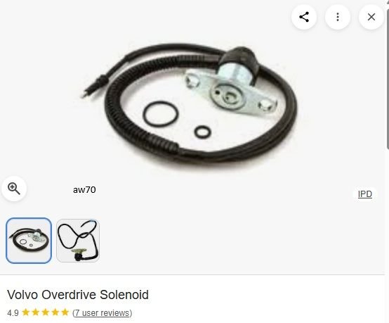

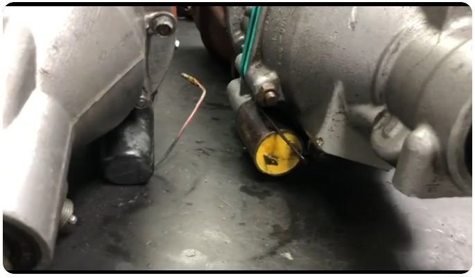

The laycock overdrive is pictured below. It's part of a M41 manual transmission. (fixed many of both the m41 and Od units a long time ago) Solenoids for those 2 styles pictured below also
If you have a bw55 automatic, (with the short bellhousing and no solenoid on the left side) - you have a 3 speed transmission. The solenoid for a aw70/71 is pictured below also.
