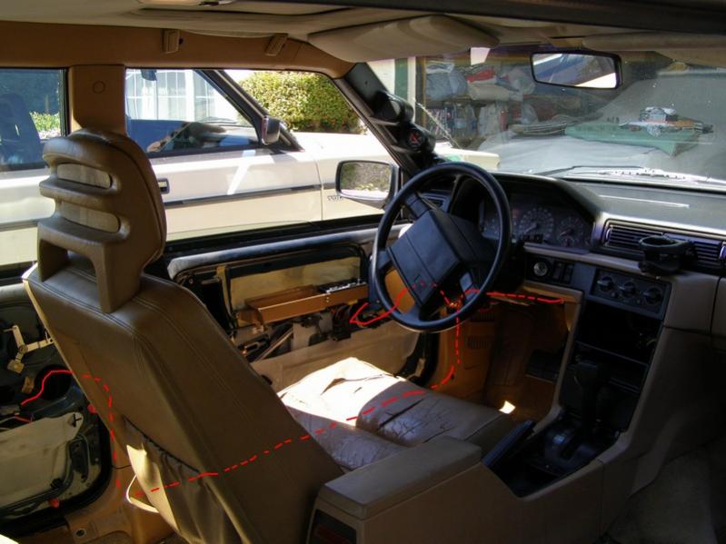

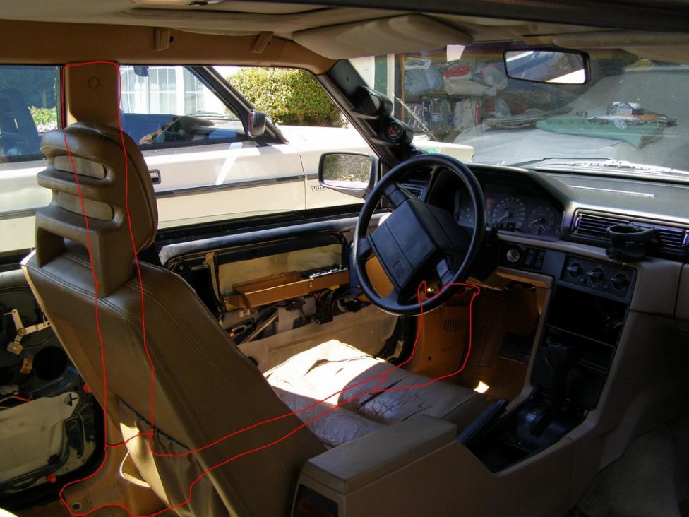

You will have to run them through the tubes on the doors...and If you feel like pulling up the carpet, you could run them under.....
I think the lower dash would be the best way to run the wires, then feed it to the center.
The wires run to the lower dash....
The red lines is the basic run of the wires...

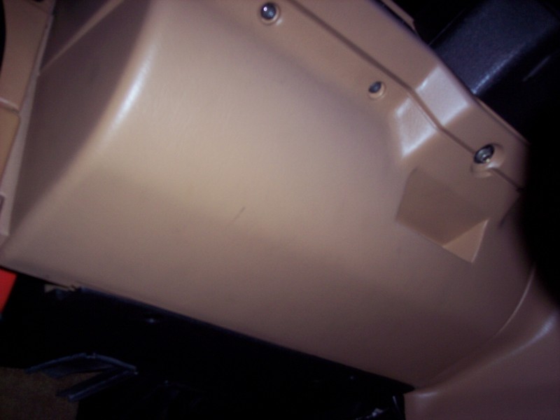

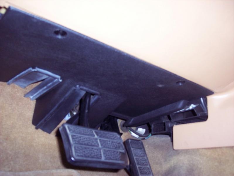

I dont have the car right now...so I am going of of my short memory....
You will have to remove the door panels, and some of the lower trim pieces, which are highlighted in the attachemnt below.... There will be hidden torque screws under the caps in the trim pieces..... The lower dash is in three pieces (the lower pedal plate, the colored interior piece and a black metal plate behind the colored interior piece). There are 2 plastic screws holding the bottem pedal piece, three torque bolts holding the outer piece, and six torque bolts holding the metal plate.....then the undersid of the dash should be exposed. The side trim piece which covers the seat belts, should only have 2 torque screws. and the driver side lower trim piece has 3 torque screw covered by rectangular trim covers.....The door panels have three white clips at the bottom, which need to be pulled out eith a pair of pliars, then you unscrew the door lock trim piece, and slide the speaker grill so it can come off.
Then all that is left is to find the exsiting wires and feed your new wires through the same holes.... I can explain it better on wednesday when I get my car back.....Or you can wait for someone else to show you......

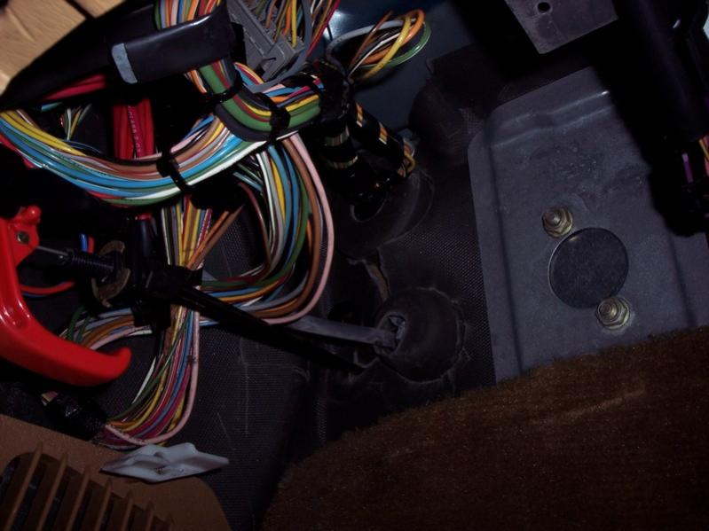

I am refering to my 91 745...
Your 93 940 should be very similar if not identical.
Here is the under side that needs to be removed: and the exposed lower side.
Good luck....post back if your stuck.
