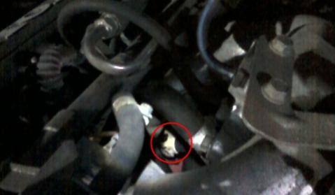

Are you sure that you got the correct sensor. The coolant temp sensor is located under the intake manifold and is a PIA to remove and replace. On the other hand the coolant temp sensor for the temp gage is still located under the intake manifold but can easily be removed. It is closer to the thermostat housing. Look at it this way if the sensor you removed was easy to do you got the wrong one. Hopefully someone here has a picture.

Oh, mine was a major pain to change. It was toward the back on the right side (facing the engine). Under the third intake. I've attached a couple of grainy pictures from my cell phone.

You got the correct one then. The ect is by the third runner (from the front) the gauge sender is by runner 2. It's equally possible that the connector/wiring atthe sender is at fault. The "potting" used on the end of the connector has a nasty habit of disintegrating. On my 89, I ended up splicing in about 6" of new wire and a new connector; the o.e. harness was just short enough to put a bit of strain on the connector.
