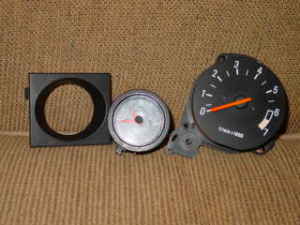

I just bought this clock (craigslist) along with a tachometer to replace the large clock in the instrument cluster. If you can find a tach, there should be an extra blade connection behind the cluster to hook up the tach. Once the tach is installed, you plug the clock harness into the back of the tach and everything works great. I was lucky enough to get the bezel trim that goes with the small clock. It snaps in place and settles the clock in nicely. I am attaching a pic of what I bought - watch for a tach and bezel on craigslist and other sites.

Volvo has made these gauges completely interchangeable. You'll find that the tach plugs in perfectly where the clock was - same screw pattern, etc.. Then the small clock "piggybacks" the tach - the rear of the tach has the three prongs for the clock harness plug - that's why the harness is so long. But it sounds like you need to rig it some other way in the absence of the tach. I can't help you there - good luck!
