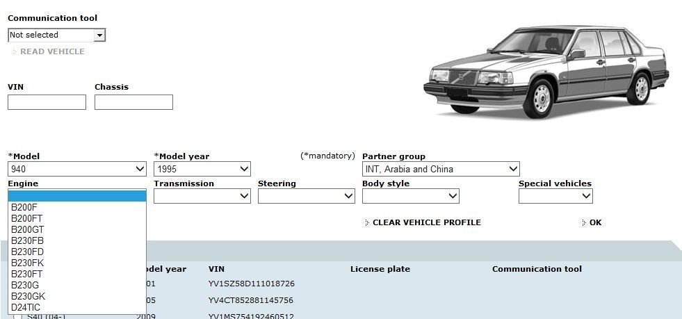

I was always told that the 940s had a white block interference engine much like the 850's of that era, albeit they were not inline 5 cylinders like the 850's.

For a 940 the only engines listed as available in the parts catalog are red block single overhead cam 2.0 and 2.3 liter versions as well as the d24turbo VW deisel engine used in some markets. Early 940s in some years/markets (91-92 in the US) had the b234 engine. Red block with balance shafts, 16 valve dual overhead cam engine. Now that engine is an interference engine - it will bend valves!
The 940se had the same body as the 960 which could (did in the US) have the 6 cyl white block engine (b6304), but still used a red block w/turbo. (b230Ft)

Roughly speaking, 940GLE has the 16V interference engine, in the US at least. Not to be confused with earlier 740GLE which have the b230f except for 1990-1991 740GLE which are interference. Confusing, I know. The 16V b234 is exceedingly rare.
