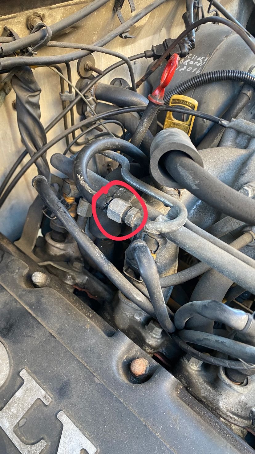

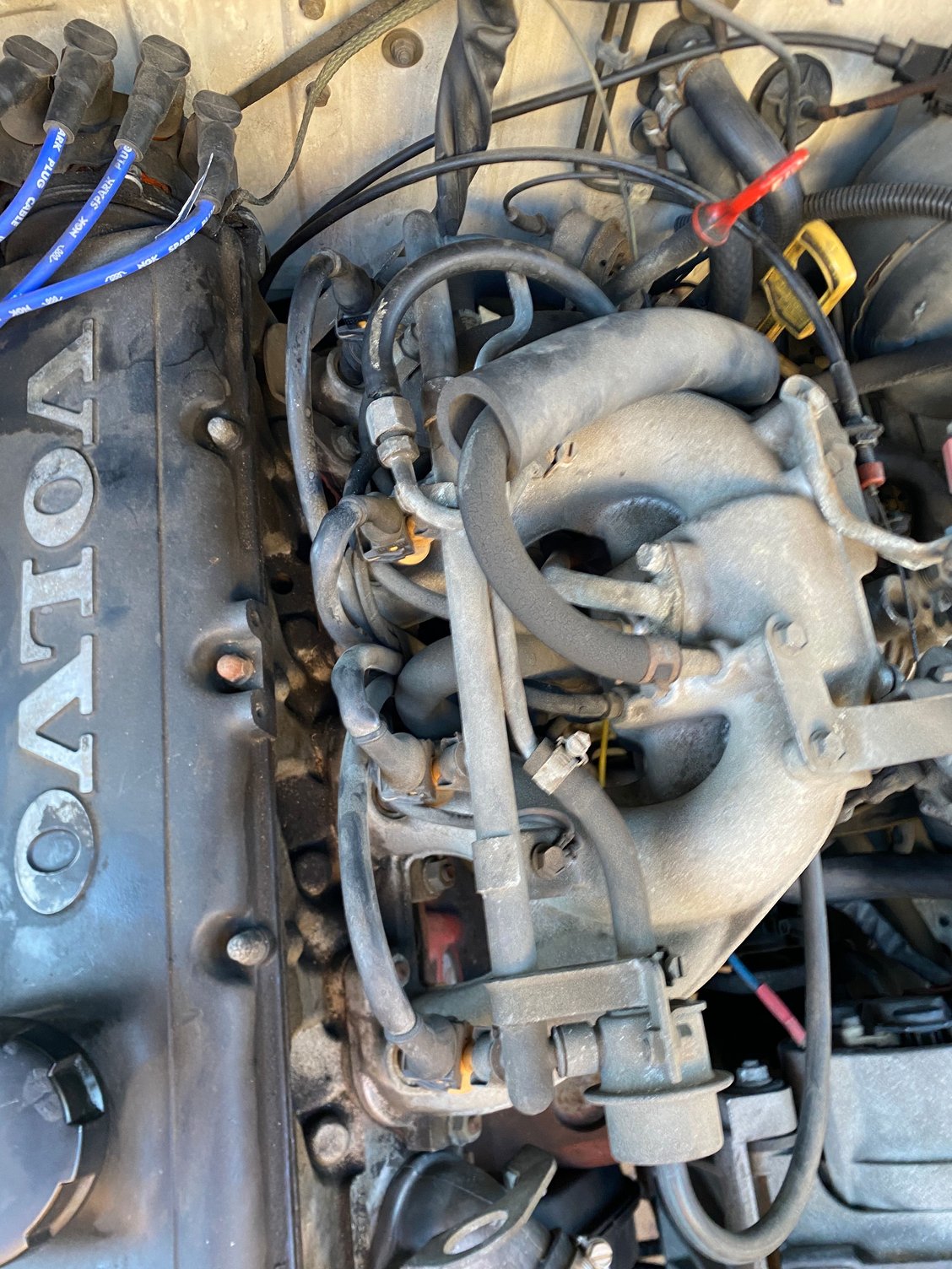

Opened the fuel line right before the injectors and cranked it, fuel comes out. What would cause all 4 injectors to stop working all at once? I attached an image of the assembly as well as where fuel (atleast) makes it. Ideas?
Thanks for all the help so far
