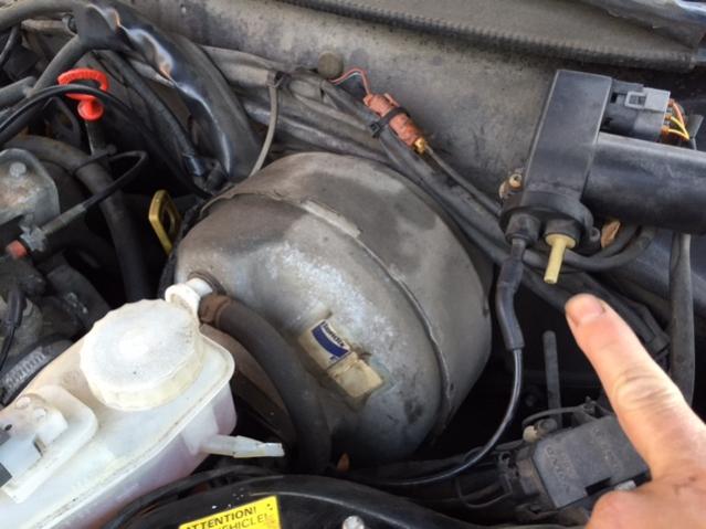

Hello Forum,
My 93 240 Wagon, has a cruise control.
It's electronically system works but usually speed down gradually after set. I looked at behind Brake booster at fire wall. There is a empty vacuum line, probably missing connection... Is this are reason why slows down?
And where it should be connected to?
Thank you for advice!!

I don't think anything's missing there. A gradual loss of vacuum means you have a slow leak somewhere: check all the vacuum lines, including the ones under the dash and the dump valve(s) at the pedal(s), and the bellows at the throttle.
Thank you! I will check vacuum lines and valves at pedals !

I checked all over vacuums lines, used electric taped at one of vacuum line elbow where was a bit suspicious. But after taped, still doesn't hold speed.

That's just the vent for the cruise motor. Maybe that unit is bad. Idk.
