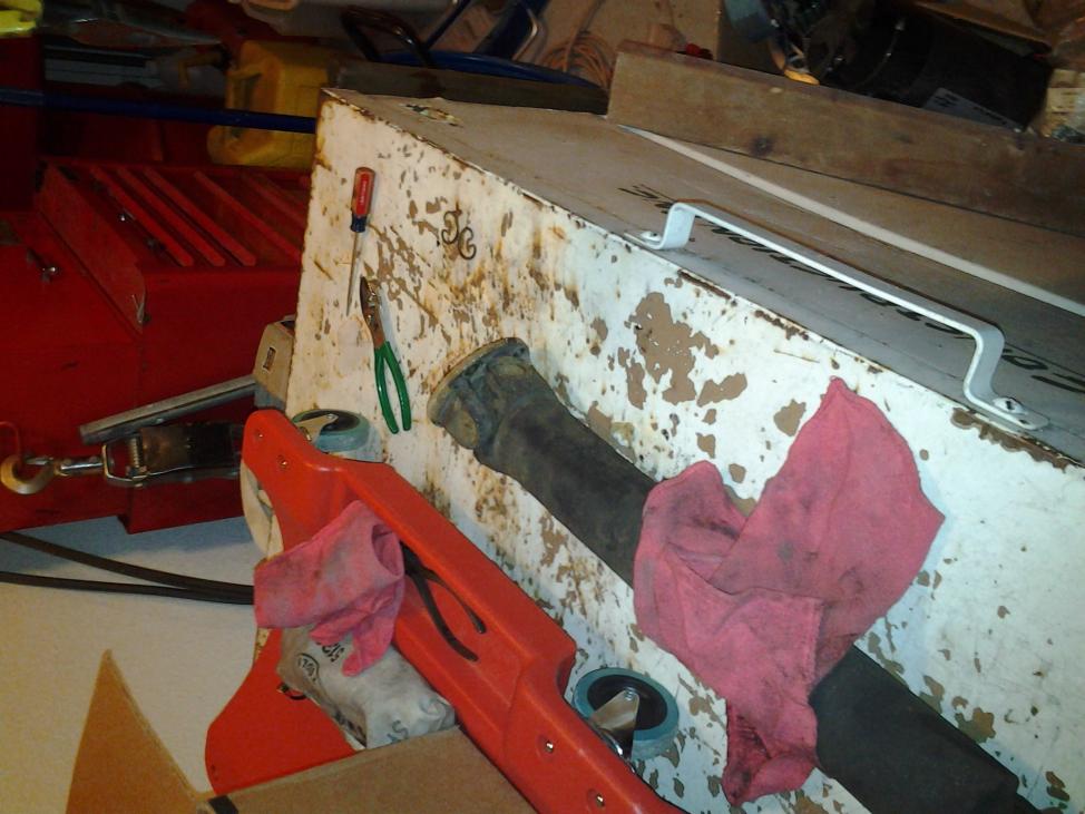

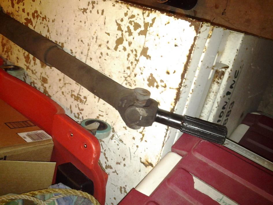

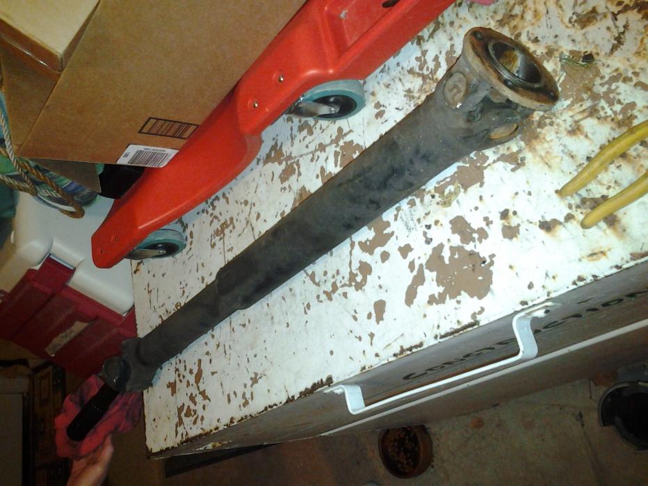

Sorry, computers on the fritz now too. Anyway, it was the original shaft, I never ordered the 1800 shaft. here are the pics that I've got of it.

Its a shafty situation...I got to do my u-joints soon...like a month ago soon. Your ECU IS FRIED? Damn
