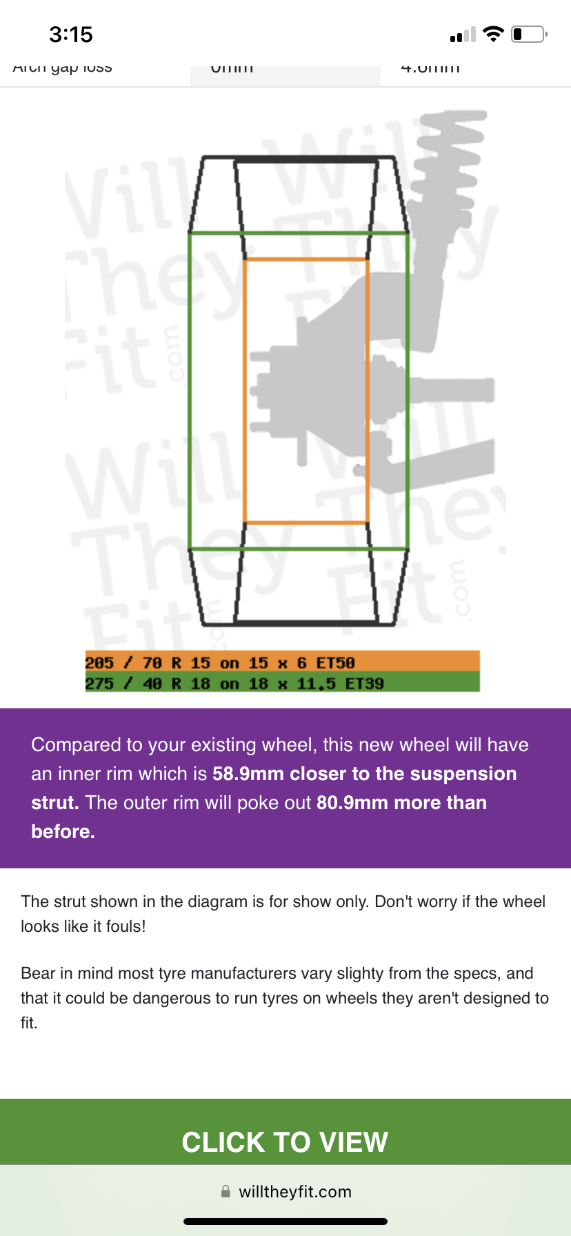

from my research online they are 19 x11.5 on the rears And 18x8.0 on the front, the offset is 31mm on the front and 39 on the rears. The pcd is 5/108 so same as the Volvo. Might need to buy/ make some sort of ring/spacer to make wheel push more towards the fender and less towards the strut depending on how they fit when on

After doing some calculations the fronts should just slide on fine as they are only 8 inches wide but the rears may struggle a bit, the wheel height is actually nearly identical due to the lower profile tires. But I will very likely need to push out the inside of the fenders. Image is comparison of the two:
