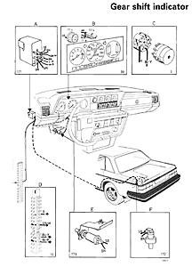

ah now that I see this post could someone send me a picture of what the wiring looks like for that light I would like to have mine working but it doesnt or do you have to be at a crazy high rpm for it to work? 1985 volvo 245 dl manual overdrive

it probably comes on at like 2000 rpm if you're just coasting down the road, certainly by 2500
this is the wiring diagram for a 1985 240 shift indicator... 2nd diagram is the parts locator... note it doesn't include the OD circuitry, thats on different pages.
