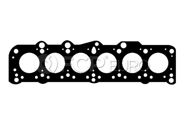

No, your puff of air is not coming from a head gasket problem. If you look at a volvo head gasket there are water jacket holes all around the cylinders - the oil drain back holes in the head/block (which would be the only place your "puff of air" could leak to) are past the coolant passages, and past the head bolt holes - so if your "puff of air" is breaching the head gasket - it would be pumping air into the cooling system also - and the compression/combustion gasses would be pumping into the cooling system - and if that bad - there would be a geyser out of the coolant bottle simply spinning the engine over. (it's really fun to see, everybody in the shop has to come look!)
So - if you really want to replace the head gasket go ahead - sounds like you are talking yourself into that job. That won't fix the 105 psi in #1 cyl. #1 may be where your "puff of air" in coming from - past the piston rings. Do a cylinder leak down test as others have suggested, do a wet compression test, test for combustion gasses in the coolant bottle - brown stuff in the coolant could be transmission fluid, but that always floats to the top first and is usually red (unless you have nasty brown fluid, which is entirely possible on a xx year old Volvo)
