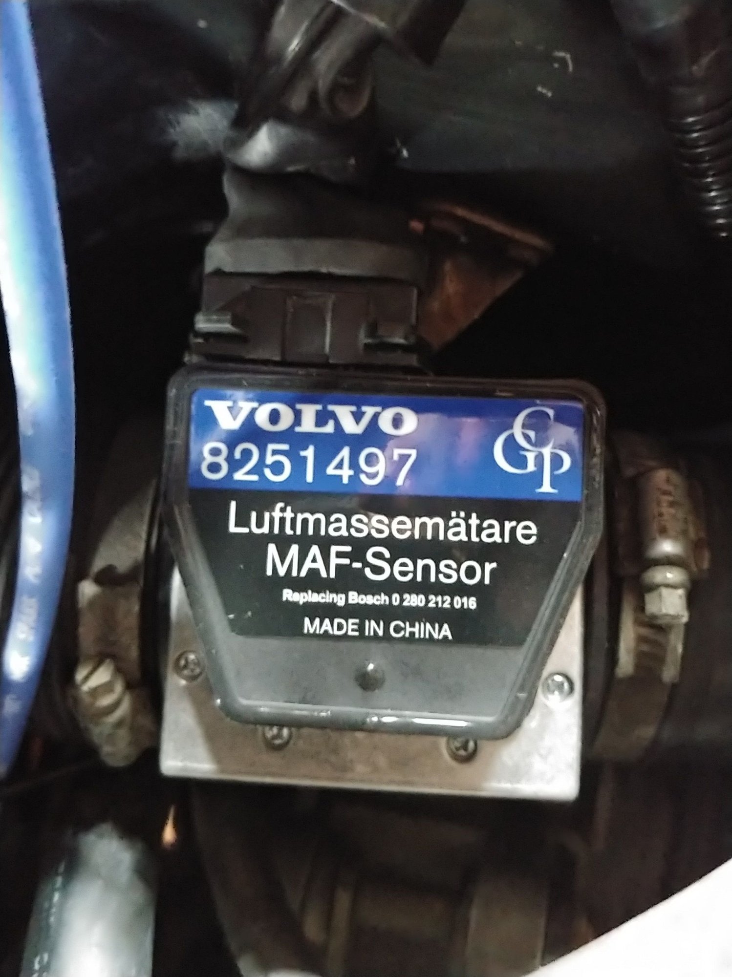

Funny you say that, I have the new 2.4 maf that I bought a week ago. Had codes for maf signal faulty or missing and burn off wire. Replaced with pic related, now I only have the burn off wire code missing/faulty and a mixture code. (Ignore the connector tab missing, bought car like it and doesn't have it)
Car definitely runs better than before, but still misses/bucks, especially at idle in drive (auto), it really bogs and shakes, but is still driveable. neutral is a healthier idle but still shakes the whole car. I have cleaned the IAC but not tested it, as I felt it would throw a light or code.
It is very possible that I'm still missing something, and I realize that.
I have yet to test, but I don't have high hopes, and that's sad, as this was genuine parts from IPD. I don't know why this whole MAF fiasco with different versions of the same part number is happening, I just want my baby to drive right :c
