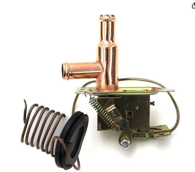

If you will take the left side panel off the side of the console - you will find the heater control valve. When you slide the lever a cable opens a simple water valve with a rubber seal that shuts off the flow of water. The valves don't really have a fine adjustment. And when old they don't turn all the way off sometimes. It's certainly possible that a new heater valve might have a more flexible rubber washer that might be less sensitive - but I doubt it. All newer Volvos use a blend door to mix heated and fresh or cooled air. Temperatures are much easier regulated with that style system - but that's not possible with a 240.

The symptoms you describe are due to a bad heater control valve. The original heater control valves were rather complex and if I remember correctly had some sort of thermostatic control that goes bad over time. In my 240s I bought a simple generic heater control valve and rigged up a cable to the slide mechanism to get it all to work. I documented on a post in Brickboard but I don't see it there anymore. I looked at the EEuroparts valve and it looks to do exactly what I did. Give it a try. Not sure the quality of the valve they use (it looks pretty cheap to me).

Act1292 has a good point - perhaps the thermostatic bulb is bad and that is not allowing finer regulation of hot water flow - I've replaced many heater valves - always for failure to shut off - but have not seen the thermostatic bulb fail (but those valves are much older now than the last time I replaced one)

Thanks ACT1292 and hoonk for your responses. I believe that could be the problem. I really am just getting tired of constantly shutting off and turning on the mechanical slide when driving long distances. It could be worse: it's not leaking, I still get heat, AND I can shut the heat completely off if I want fresh, outside air. But I will get to the heater control valve and see what's happening (or not). With the kit I ordered, I get all replacement parts at a good price. I could replace the unit with the kit I ordered from eEuroparts https://eeuroparts.com/product/profe...weden/87431998 as it contains: (1) Heater Control Valve (2) Heater Hoses (1) Hose Clip (1) Control Cable (1) Mounting Bracket (1) Insulation. And see if it fixes the problem And I can keep the original parts as they somewhat work. As far as the cheap parts comment, this company says Proparts is their best aftermarket parts provider (other than OEM0, and they are in Sweden. Either way, this is a part I literally use only 4 months out of the year when it is real cold, and I need to (blend) the outside air with heat from the heater core. Another (cheap) fix may be to install a ball valve on the intake heater hose on the engine side and partially close it during the winter in an attempt to regulate the heat. Also, by doing this, in the summer I can completely close off the circulation of antifreeze into the heater core as a preventative measure should the core decide to leak inside my car. Remember, I have a non-A/C car, so that is that.
