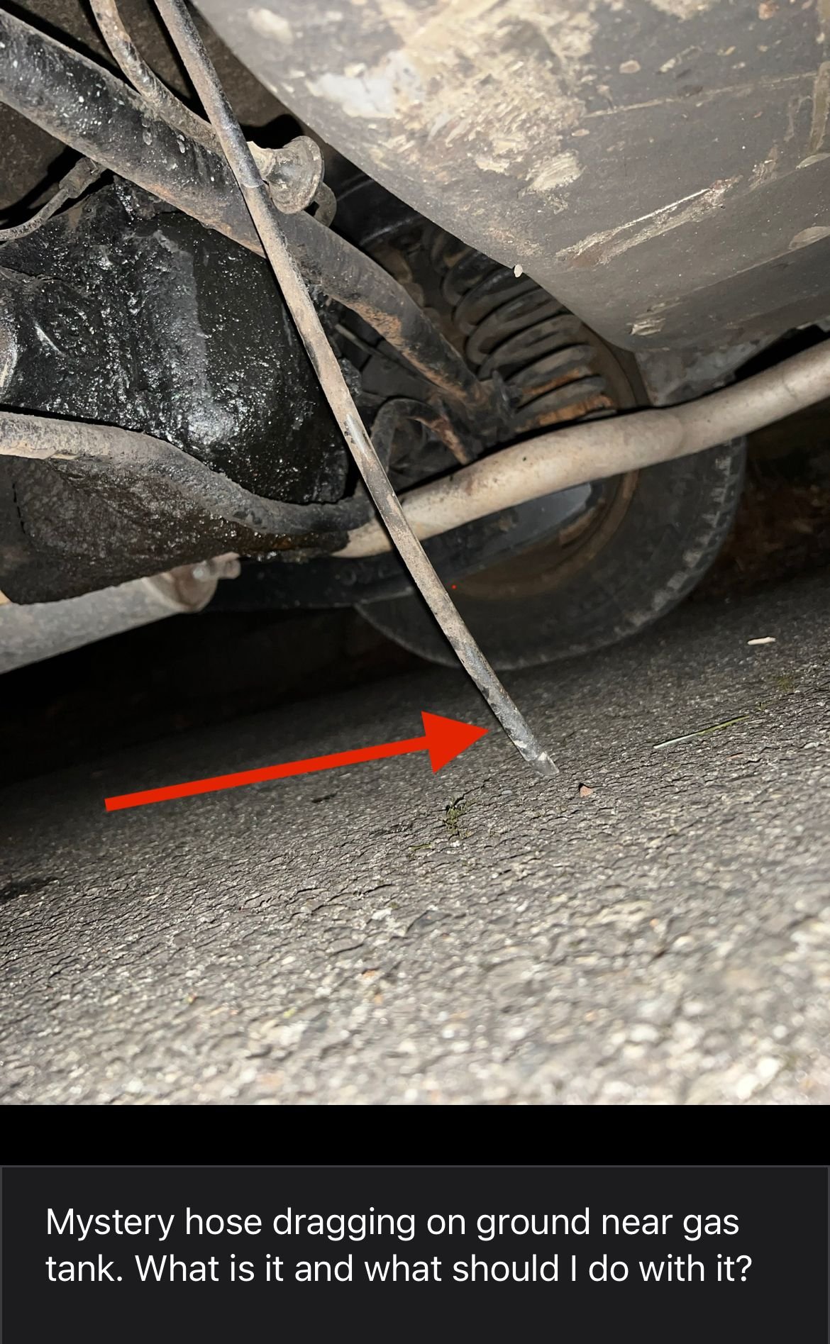

One other question - I noticed there's a rubber tube near the gas tank dragging slightly on the ground. I'm not sure what this is? A drainage hose of some sort? Is this something that needs to be trimmed or zip tied up to something? Here's a pic. Thank you for all the help!

the tube looks like the water drain from next to the gas cap. trace it back up to see where if that's where it came from and
re-attach if necessary.

Thanks Silvermine - I just got it zip-tied back in place :-)
