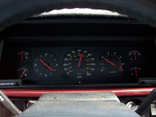

Most 91 740T's had a 3.73 rear end if equipped w/ the AW71L automatic. As mentioned, check the operation of the OD. 3K doesn't seem too steep but higher than some.
