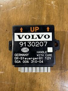

i forget where it is on a 940, but there's a little box thats the cruise control unit, and its partially analog, and they die with age.
ok, the parts diagram is really vague, but I think its on the far left side of the driver footwell, tucked in behind the dashboard, probably not far from the stereo amp thats up there too. google suggests its a black rectangular box, connector on the bottom, part 9130207 or 9130081 (maybe some other numbers, too), they have a Hella logo on them too, as well as VOLVO.
