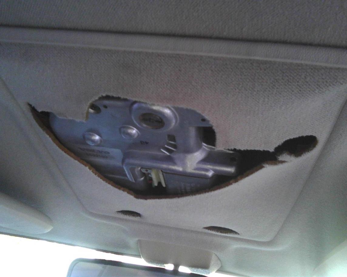

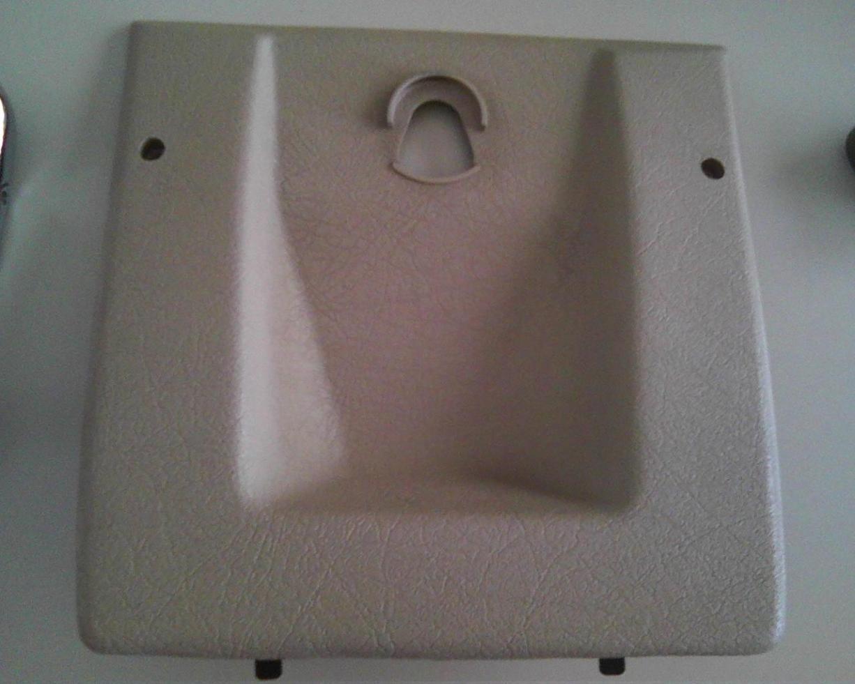

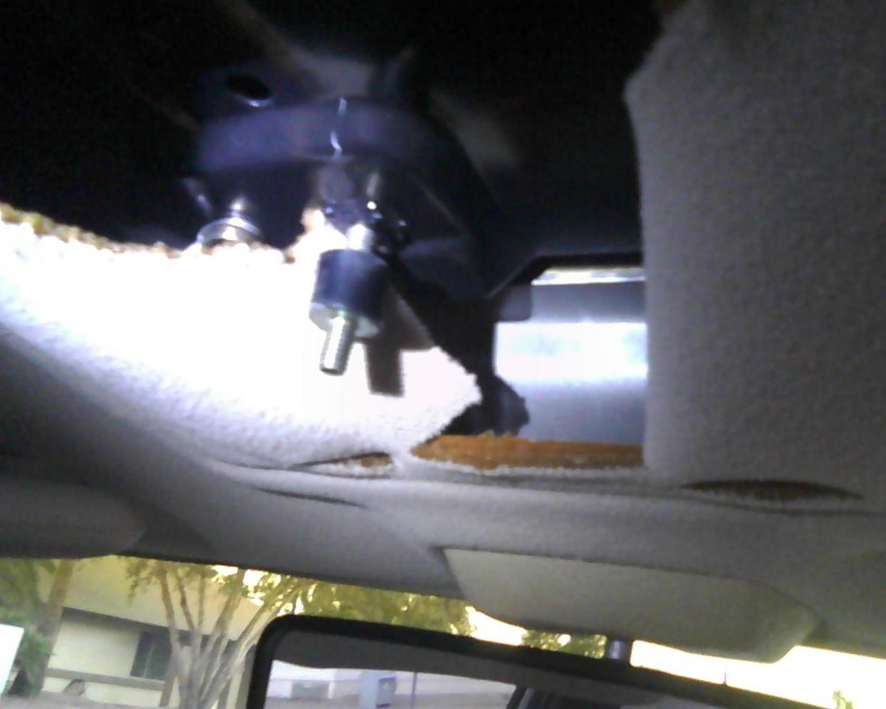

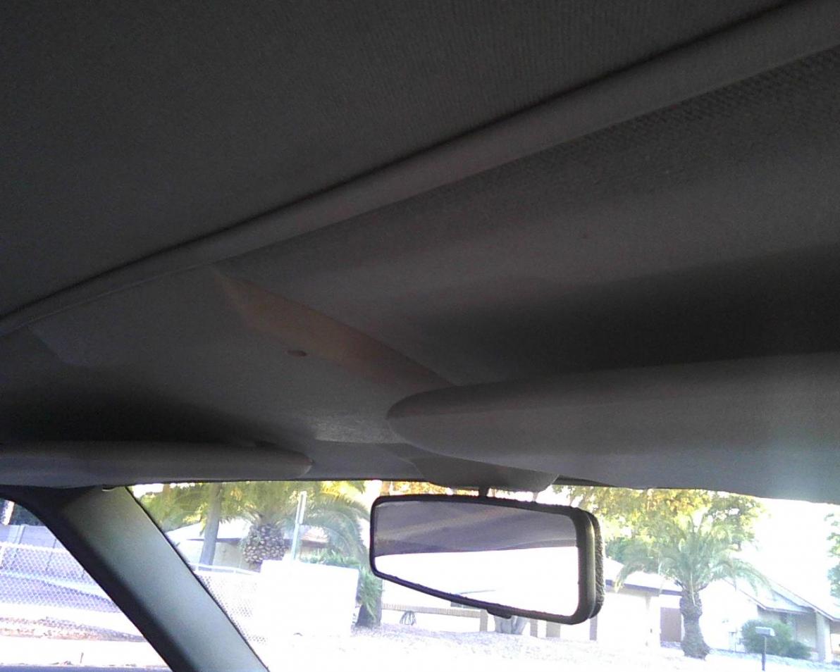

I just did this for my 94 Volvo 940, I took the manual handle, plastic piece, and gear. Works Fantastic!

Here are the rest of the pictures, thank you for the helpful information everyone.
