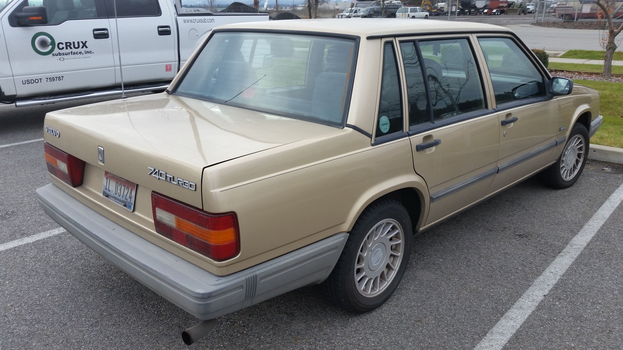

I def. do not have it then, and this Volvo has a sticker in the rear c pillar window on passenger side...something about Volvo exchange vehicle or special import? It says "SPECIAL DELIVERY"..I can see it on my thumbnail pic, when I enlarge it. It is a factory sticker, circular.. I can take a pic of it and post. It looks like it has been there since new. It really held up good considering the age of the car.
I reside in north Idaho and the car is from this area.
I am ordering the sleeve seals, for 10 bucks worth a shot.

You can see it in rear passenger window, if you zoom in on it it is legible.

That's a European delivery sticker. US spec cars delivered in Europe at the factory, aka Special Delivery, Diplomatic Sales, etc.
740 started to have airbags in late 1988 with the Turbos, and ABS about the same time frame, the NA cars got them a year or so later, if memory serves, my new '89 740 turbo had a bag and ABS...
Your 740 has 960 wheels, half inch wider than the regular 740 wheel for 1991. Volvo got cheap and dropped the 16" Hydras from the 1990 Turbo for the 1991 model year...
