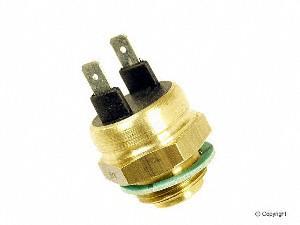

Now here are the three versions of the sensors... The push in, the threaded that screws into the radiator, and the screw in that screw in line with the lower sensor port...
RADIATOR FAN SWITCH
WAHLER - SCREWS INTO RADIATOR - THREAD TYPE
EXCEPT TURBOCHARGED86-88IMC802 54066 087FAN SWITCH19.0711.230.000
This is one I'm hoping to get to fit into the autozone radiator...
___________
Here is the kind that is push in:
RADIATOR FAN SWITCH
FAE - PUSH-IN TYPE - PUSHES INTO RUBBER GROMMET
EXCEPT TURBOCHARGED85-88IMC802 53005 615RAD FAN SWITCH20.1911.890.0
Autozone also only lists this type. I couldn't find a listing for any threaded switches in the autozone site...
Attached Thumbnails Metal Radiators & Sensor - Question..-volvo-threaded.jpg   Metal Radiators & Sensor - Question..-volvo-nonthread.jpg
